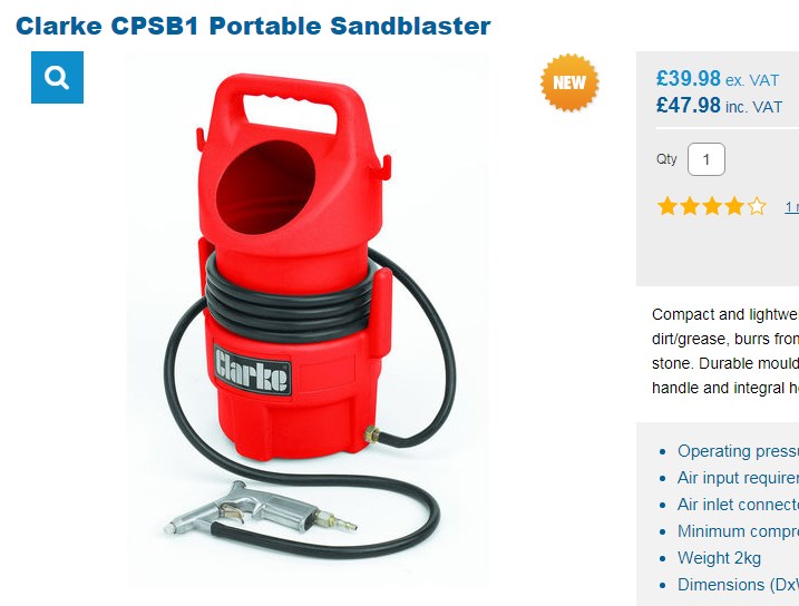

    I bought a portable sand blaster, which i hooked up to my compressor. only cost about £35.
    same as the one in this picture.
    as i say, depends how deep etc. then i would imagine its how much pressure is required to do the job on the stone properly. you can keep doing more and more passes over it i guess.
    i know for the likes of glass etching there is not a great deal of pressure and the sand is very fine.
    you just just sand blast vinyl, cut a stencil and protect surrounding area and fire.
    depending on pressure, your stencil may need to be a very think aluminium or even composite. im guessing here though as i have never done it on stone.
    ive used ours on hard ground in rust on steel with my portable unit and it blasts it clean off very easy.
