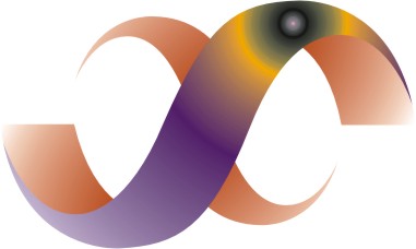

    Can anyone help please? I have an eps which looks great in illustrator but I import it into corel and looks terrible. Need to print & contour cut this today (Sunday). Anyone tell me what I am doing wrong please?

    do you have X3? if not try saving it as EPS 2
  • Nick Minall
    24 February 2008 at 10:14
    well X3 dont like it SignLab opens it ok no SL leaves bits of it.
    Try making it a PDF in illustrator seems to work for me.

    this is strange Nick, see what is happening? Imported the pdf
    I use corel 12

    I will try making it a 12 file then

    Try this then…

    Perfect Nick, thank you very much. Any idea what was happening? I know I had a few last night but this was driving me mad this morning. Maybe time for X3

    no idea… x3 would not open the eps had to open it in illy and make it a pdf then to 12 in x3 😕
    Corel 14 is out now may be you should try the demo and see if that works?

    Tried it in X4 it came out green, solid top color with a green blend underneath if you deleted the top layer so nothing like what is posted

    are you using postscipt 3 to import?

    I distilled the eps in Acrobat (V5) imported into X4 which imported fine with shapes as fountain fill and correct, applied boundary and job done. I had no luck importing the eps or a pdf made from Cutepdf.
