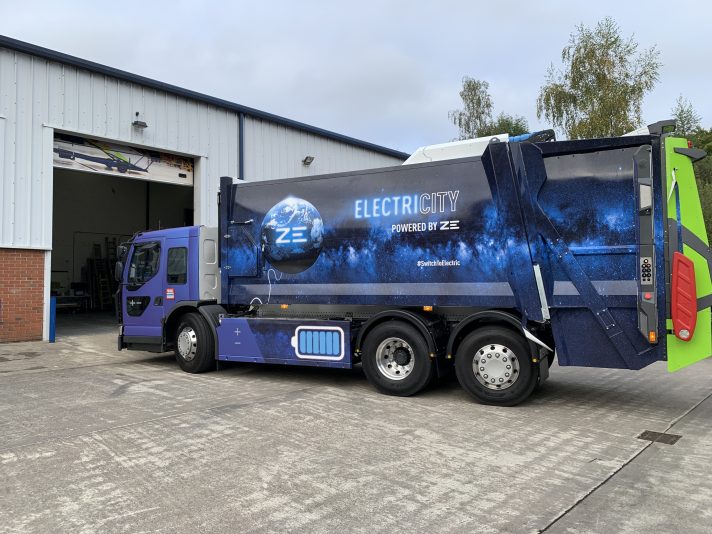

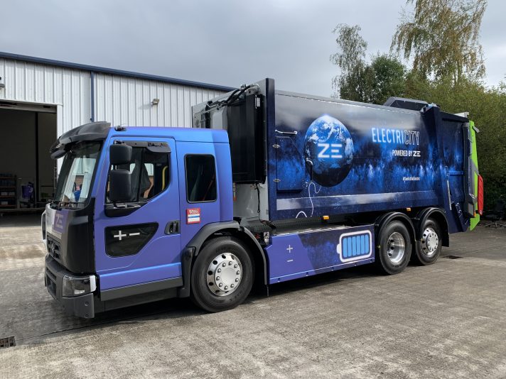

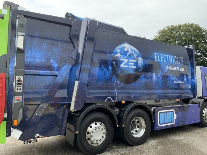

    Hi All
    Haven’t posted anything for a while but thought I’d share this from last week as it was an interesting vehicle – an electric bin wagon with around 2 tons of batteries! However, acceleration and top end speed just the same as a regular bin wagon – disappointed it wasn’t Tesla quick.

    14 September 2021 at 10:51
    Very impressive David, that’s a big wrap!

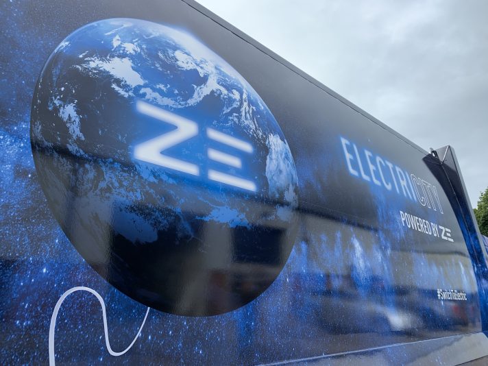

    Did you use a cast or opt for using a polymeric for it?

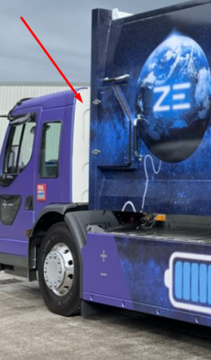

    might be just the sun, but is the cab a print or a two-tone wrap vinyl?
    thanks for sharing, always great seeing what you have been up to, mate.

    How long would something like this take to wrap?

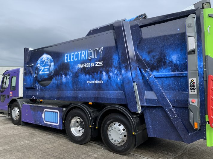

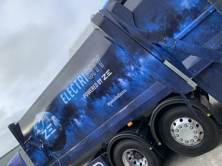

    I hope this makes sense – Did you wrap the front/backward facing faces on the box section parts towards the back?
  • David McDonald
    14 September 2021 at 19:23
    Hi all, thanks for the kind comments.
    Rob, its just the light the cab is self coloured and everything else is printed cast.
    Karen, there’s 6-7 days of total effort invested in this one.
    David, the rear sides were the hardest part of the whole job, all the ‘box sections’ are fully wrapped, albeit many of the returns are pieced as the depth/angles were too much to work in – we took a lot of design time to make sure there was still good registration even through all these patched areas.

    15 September 2021 at 22:18
    Ahh OK, I see it now mate…
    Bizarre how the light makes it look like a colour-shift finish.
    I think what made my mind up was the rear of the cab being white. please don’t tell me that’s the light too, or I’m losing the plot! 🤣🤣
    It’s a great job to show customers, due to the size and complexity of the work involved! 👍
    The box sections that are wrapped on the side, have you done that from a single sheet “so-to-speak” or did you print parts twice to allow for wrapping the flat areas then those box section parts?

    Hi Rob
    We put a single drop over these areas, cut dead centre on the high sides of the boxes and dropped into the low panels, coming 1 – 2cm forward onto the returns depending on how thick the weld lines were. We did the same again the opposite way – covering the faces of the boxes and back enough on the side returns to give a 1cm overlap. We didn’t print another full drop just the individual fronts of each box, so yes a double print.
    There is another discussion thread on the go from David Hammond at the moment about the profitability of bigger wraps against multiple non-wrap / part wrap jobs. We made money on this job but I’d want to add a considerable amount more if a repeat of this job came in from a different customer. Good for the portfolio and this was from valued long term customers but always much harder work than you think – I need to be more when installing times!! Multiple smaller jobs are nearly always more profitable than large wraps if you have time/resources to do both.

    27 September 2021 at 12:16
    @david-mcdonald
    Thanks for the explanation David, makes sense, mate. 👍
    I agree with you regarding big installs like this, it is so easy to spend more time than planned on it. Everything is guesswork when we quote, but when it comes to doing it, the process just eats up time and profit very quickly.
