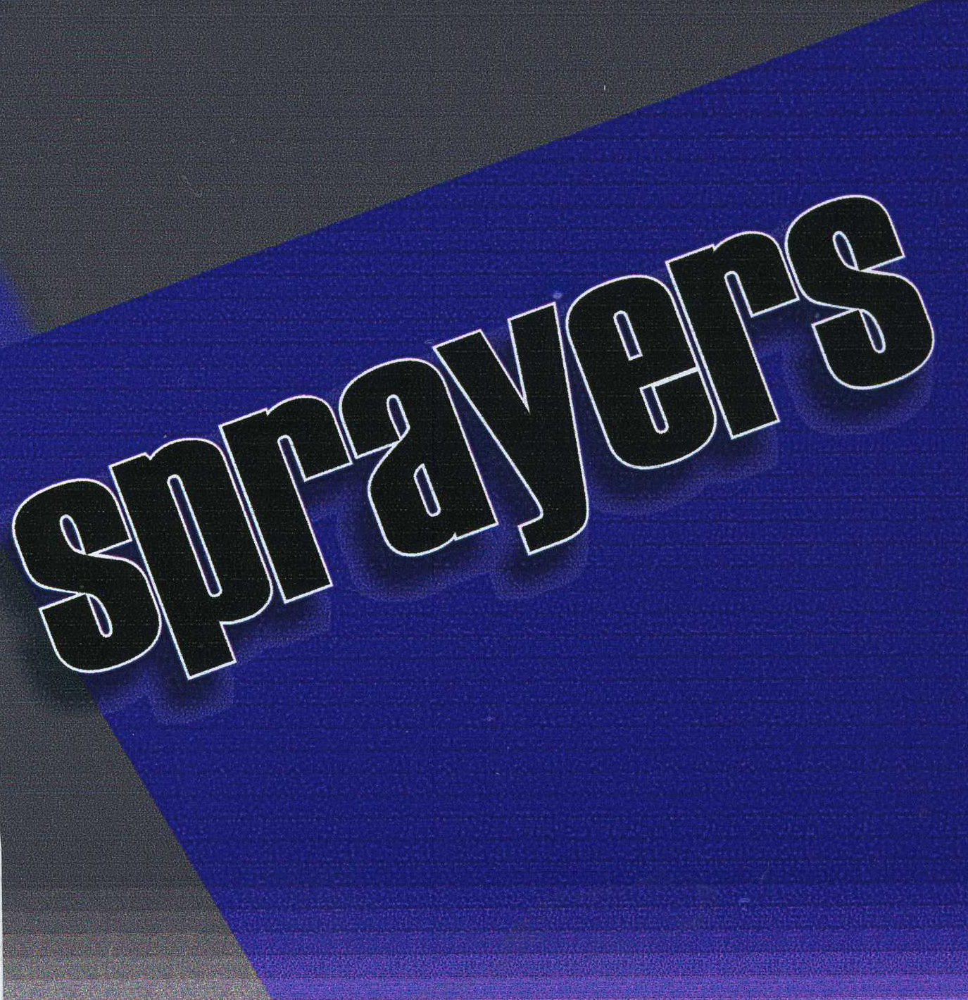

  • Rich Cooper
    2 September 2014 at 16:51
    heres an image of the design, ive printed a small sample off
  • Chris Wool
    2 September 2014 at 17:16
    can never remember which but you should see the bad effect in the preview
    to do with a mix of rgb shadow and cmyk background if sending as a cmyk from corel change in the eps export to rgb.
    also the printer needs calibrating
