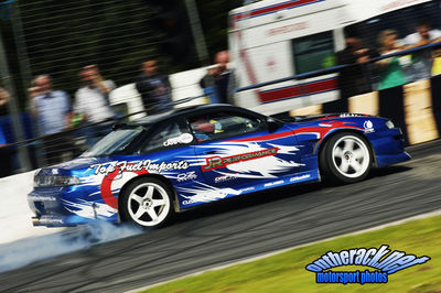

You may struggle to get an vehicle outline for the guys car in which case you would need to photograph the car and then scale it up. From there it is really up to you what you do. You can either design something from scratch or use something from a vector CD and then just alter it to suit the vehicle.
If you have a jpeg of it then thats all you need as long as it was taken side on and not at a silly angle. As for size then try the manufacturer for an overal length of the vehicle so you can scale the picture up. If the jpeg is taken at an angle then sometimes the sales brochures for the make and model of car have images you can scan and use.
