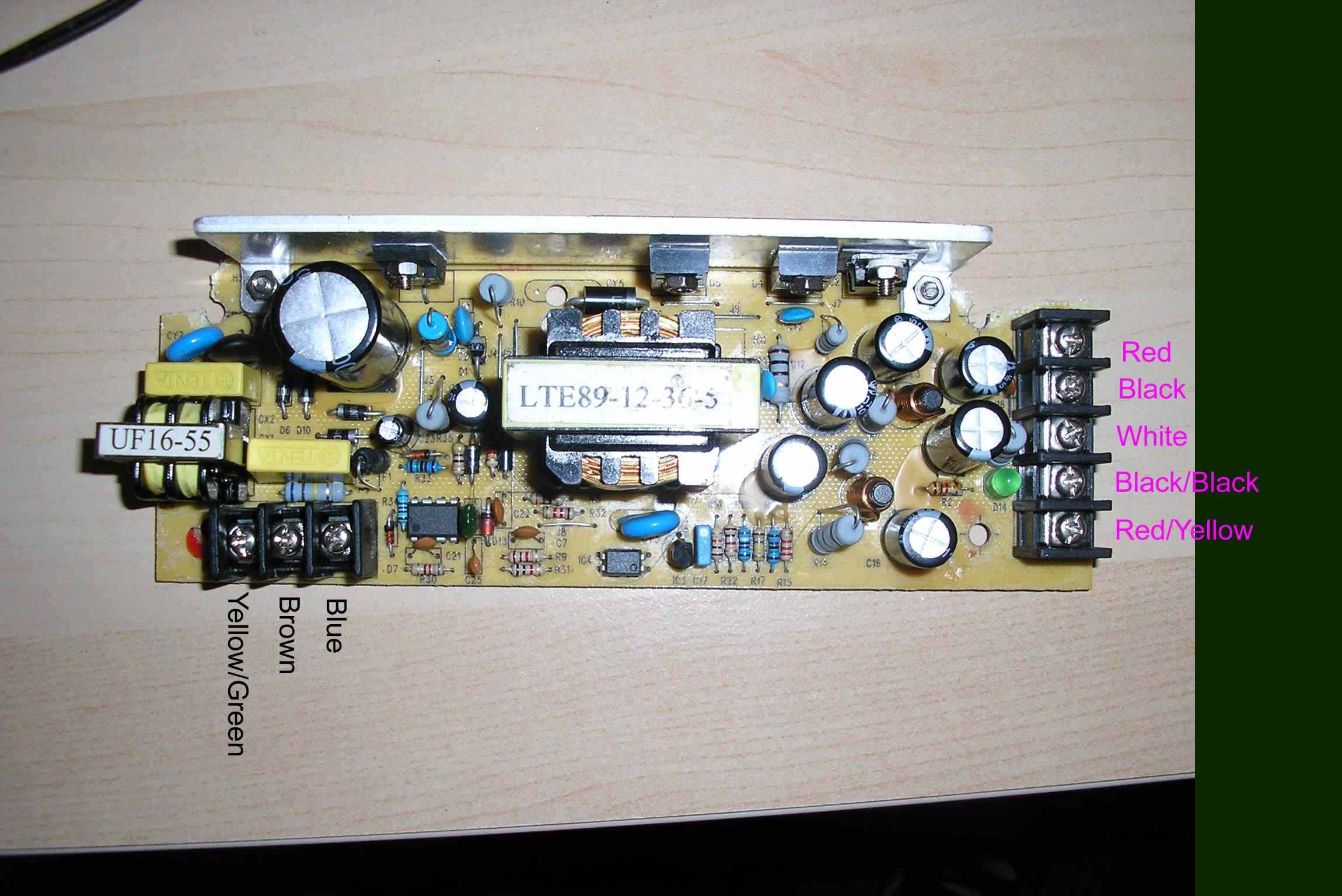

blue- n (neutral)
brown – l (live)
green/yellow – earth – the last one with the lines.Same wiring as fond an most common household plugs and electrics.

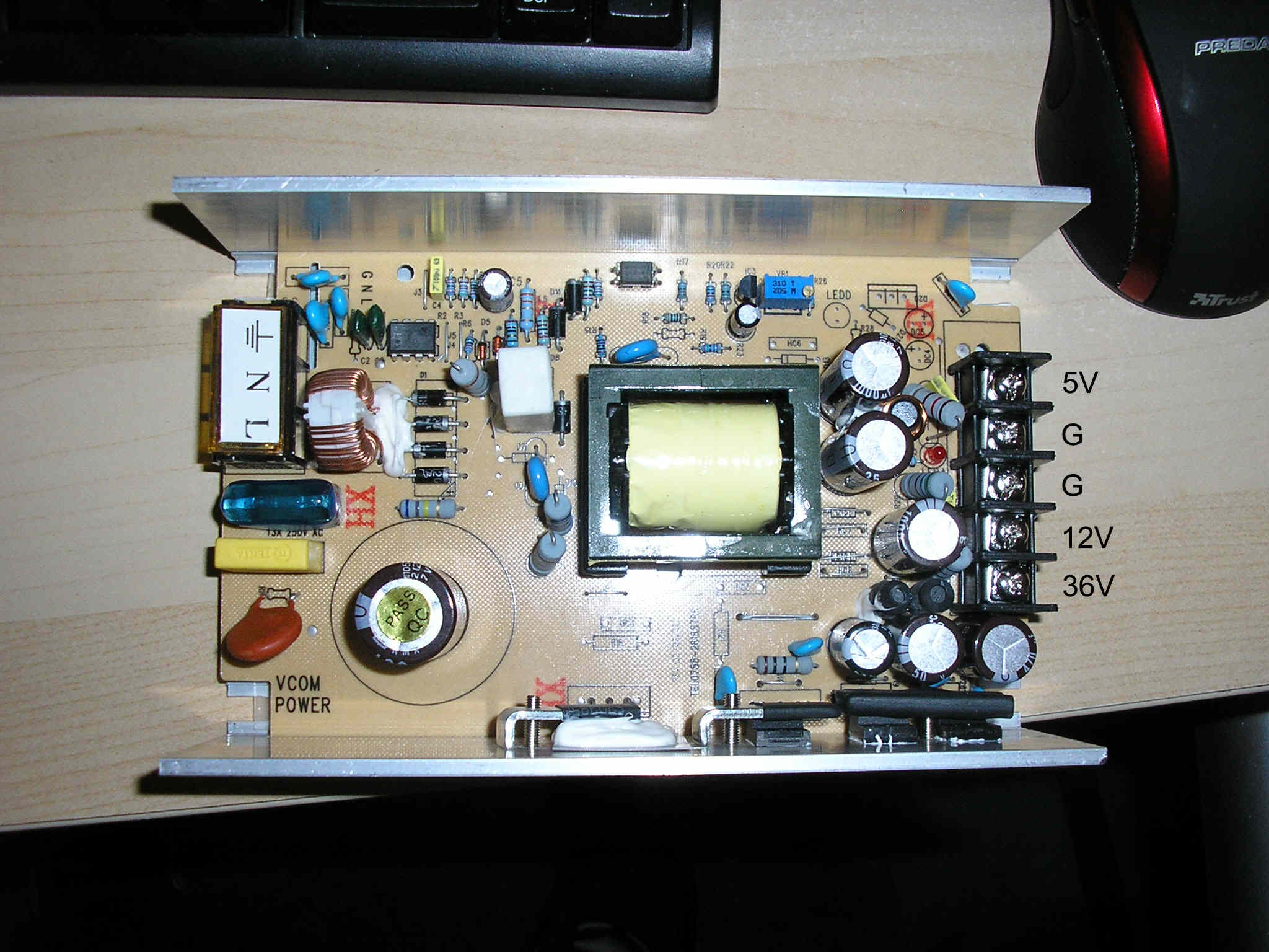

Do you mean the connections for the output terminals ( the 5-0-0-12-36 ) part ?
If the old board isnt working ( i.e. no power going to the output terminals ), without a schematic your a bit stuck as you know what the output voltages are, but not which colour wires they need connecting to, and if you ( for example ) connect the 5V wire to the 36V terminal you are probably going to fry the rest of the chips.
TBH I would have thought the person who supplied the power supply should have a schematic of the cutter and could tell you, or the person you bought the cutter from in the first place.
In fact, if you cant get this info, the only way I can see you can make sure you connect it up correctly is to find someone with a working one and get them to measure the voltage on the output terminals and tell you which colour wire is for which voltage.
Dont assume that the 5 terminals are in the same order on the new board as the old one as its quite possible they arent !

Assuming you did test the power supply to make sure it was definitely dead ( and checked any internal or external fuses on the machine ) – in general power supplies stop working because one of the electrolytic capacitors fails ( the large dark blue caps with the metal tops ) – the only other thing that generally goes wrong is a fault with the transformer, and this isnt that common.
