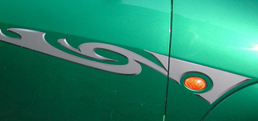

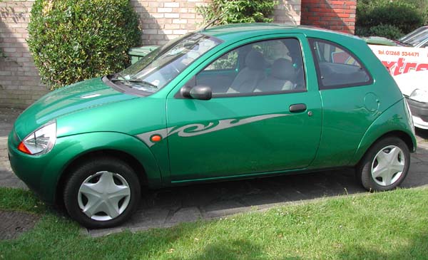

if the spraying is going to take a lot of wear as on say the front of a truck and it was a fine blend then i would use a foam roller and lay off with a brush a coat of one shot UV clear just to save on wear though most stuff stands up ok withoutonce you get the hang of the airbrush youll wonder why you hadnt got one before
though posted before these graphics were done in inks using a mask
Terry
Wow, Terry thats neat.
Do you make up the mask yourself or is it one you have purchased? -
I see I have lost the power to edit again 🙁
Got anymore photos please terry, can you give directions if you have? -
this is a clearer view overall
the design was drawn over a photo in signlab digitised cut in silver then before it was fitted i cut the same again as an inline )mask and sprayed just shadows and highlights removad the mask taped and appliedonce you have the design sorted the fancy bit only takes minutes
ive done another tribal for the back just got to paint that the same
ill take some pics to showTerry
i think it looks great terry, the other picture gives a better veiw of the work.
thanks for taking the time to post mate.. always a treat to see your work 😉(just for those that may not know, if you click on the image loaded it should popup to a larger version if there is one) this is a board modification to give easy screen veiwing of replies etc so you no longer have to wait on large images to load.
