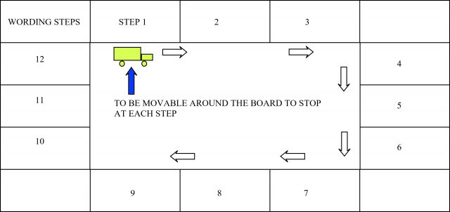

    Hi All, it’s not very often I ask for any help as I can usually find answers in the forums. If any one has any idea on this or has done something similar any advice would be very appreciated. I have been asked to do a display board printed on to foamboard with steps going around the board. Then it has to have a movable image that can be placed at each step as they go through the lesson. I was thinking Velcro but it would get a bit tatty after a while. I was also thinking ACM but magnets wont stick to Aluminium, as If anyone has any ideas that could help could you please let me know.
    Thank you for any ideas.

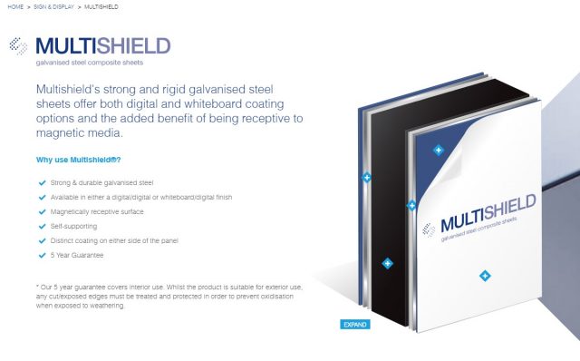

    Multishield from Multipanel UK, is what you’re after.
    multipaneluk.co.uk

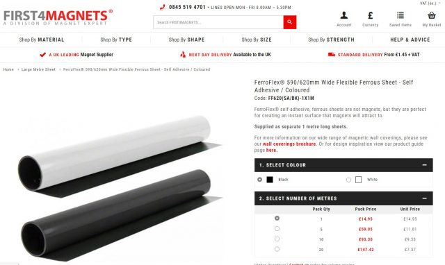

    You can buy ferrous sheet material which is self-adhesive and can be applied to any background to produce a surface that magnets will stick to.
    first4magnets.com
