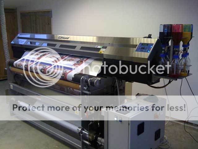

    We have just branched into Dye-sub on the larger scale with the fairly new and still developing world of direct to fabric sublimation, where a dedicated heat press is no longer needed.
    The machine is a converted Roland XJ-740 bolted onto an ATP calender and control unit. This has enabled us to print directly to specially coated fabrics that sublimate when fed through the calender (heater).

    Do you have a photo? I can’t quite envisage what you are describing.

    Yes, just found one from my phone of our installation.
    It’s essentially an XJ-740 sat on top of a framework which has a number of rollers for holding the fabric in place and directing it through a heated drum (the Calender) post printing. This sublimates the dye directly in the fabric with no pressure.
    The machine is controlled by the ‘box of bits’ in the right bottom corner and only uses the Roland clamp when printing to transfer paper. Otherwise the ATP machine has full control of the media feed, heating and take-up.[/img]

    Wow, that is some machine!
    So you print onto un-finished fabric, then have them finished later?
    Do you buy in the fabric already treated? Presumably this is a polyester coating sprayed on?

    Fabric comes polyester coated as you suggest which allows the process to work. By finishing, if you mean hemming, hot knife, stitching etc yes these are all done afterward.
    The materials come on rolls that are loaded onto the feed roller which is situated at the bottom rear of the ATP machine.
    The route which the fabric takes really is something else. It has a diagram to make sure you load it through the correct rollers at the right points and you use between 3-5m of material just setting up!
