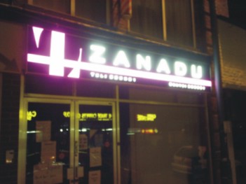

Posted by Andy Gorman on 22 November 2004 at 22:58I’m looking for some advice on digital camera use.
I do a few lightboxes now and then and would like to get a decent picture of them illuminated. As you can see from the attached photo, the results with my existing camera tend to be massively overexposed. So, is there a setting in the camera I should look for to help me get a better picture, or alternatively, can anyone recommend a decent camera that would enable this type of photography. I do have an SLR that would do the job but would like to use digital for the convenience (and the lack of processing costs, I’m very mean).Rob, please move this post if necessary, I apologise for posting in the wrong forum, but I wanted to include the photo.

Does you camera have an aperture function Andy?
Cheers, Dewi
I’ve just found a setting called ‘exposure’. I think I may have to experiment with that. I’d still like to hear any reviews of other cameras though, as this one is a bit cheap and cheerful.

Digi Cams are great, the thing is a pro photographer relys on lighting skills.
A light meter is essential for this sort of pic, also a tripod and some other lighting. If you can adjust aperture and exposure settings on your camera, just take as many different ones as you can and maybe you will get the right one.
Try it in daylight also you might get a better result.
Peter -
I’ve tried adjusting the white balance, exposure and also the light type (tungsten, fluorescent etc) but the results are still poor. I may have to use the old Pentax MX. I know I can get a perfect picture with this. Maybe this is something that a digital camera isn’t up to. At least, not the budget version I’ve got.

Have you tried different flash settings, or is your cam not able to be adjusted such? I find that with a slower flash setting I can get most of the night shots I need when artificial light is present. It would work fine for the example you posted.
K
Nah, it’s a pretty basic camera. The only flash settings are on, off and anti red-eye. I think I may have to get a slightly more capable camera. If anyone has achieved the results I am looking for, I’d be interested to hear their recommendations.

You need a digital camera that has timed exposure for neon and night time shots – and definately a tripod
Basically a camera that has manual overide

a Camera exposes most shots to a “neutral grey” , thats why at the beach or in the snow , the camera shows the white as a dirty grey cos there is so much white.
In your case , only a small portion of the scene is well lit or bright and the rest is dark. The Camera tries to expose for the dark , lightening it up in the pic however it overxposes the backlit sign.
Essentailly , you have to tell the camera to underxpose so that the light sections are exposed properly. If you had zoomed into the sign very tightly , you may have gor a better exposure.
This modification of exposure can be achieved in manual mode quite easily. The Camera’s light meter should show what is the correct exposure in terms of shutter speed and aperture – you have a choice , a higher shutter speed than recommended by the camera which might allow you to hand hold the shot (most ppl do ok at 1/60th of a sec and up) or a smaller aperture (the smaller the aperture , the more that will be in focus in front and behind the object you are shooting – called depth of field).Any decent Camera will have a manual setting. As one poster said , a tripod is almost essential for this .
Depending on how serious you are about photogrphy , the range of digi cams caters for all. In your case I would buy something that is around 5 mpixels and has a nice zoom lens (3x zoom is useless – cameras are out with 10x zooms and image stabilization – ie the camera compensates for your shaking). You can get something really good for 3-400 quid.
A DSLR will cost you a lot more , but then you have the choice of lenses and if you already have an slr with decent glass , it might be worthwhile looking at the Digital SLR that accepts your lenses. Canon and Nikon are the market leaders with DSLrs , the Canon 300d or the Nikon d70 are the entry models.
Tho you dont need a flash for the pic you are taking , the onboard flashes of most digicams are useless , had you taken the photo with an add on flash on one of the more complex cameras , you would most likely have got a great pic , with the sign perfectly exposed and the background lit up too , the programs that drive the flash and cameras today can account for mixed lighting and complex stuff.

on some digital cameras you have an option to lock the aperture, you focus on the bright part or the part that looks white to the normal eye, with the focal point in the view finder, zoomed in if possible, then press the lock aperture button, then centre the sign and click, i use a cannon 60d i also got a 30d which is about 3 years old (this would be a good second hand option) otherwise look for any camera that you can lock the aperture on a certain part of the subject whilst taking a pic in automatic mode

Lashed out and bought a Nikon D70, and although you need to be a pilot to steer the damn thing, I would suggest it would overcome any problems in taking the ‘odd’ shot for display etc. If you do wide format printing, it has the added bonus of taking RAW photos, which if you know photoshop, lets you manipulate a shot way better than an ordinary jpg file.
You would need to take the night shot on a tripod, but the results would let you build a fairly impressive photo portfolio over time.

Go back and take another photo without using your flash.
THat may give you an effect that you like. -

like andy12 said that should do it ! but you’ll need a tripod or you’ll get movement and blur for-sure. press down gently on the shoot button trying not to move the camera on the tripod, exposure set to auto, flash off
