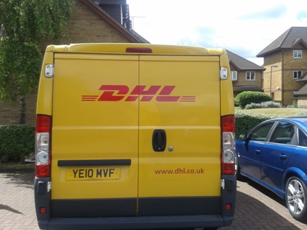

    Hello All
    I have been asked to put right a crash repair job it is a rear door on a DHL citreon relay. The van was white but wrapped in yellew vinyl,the colour match that someone else has done is awfull the vehicle is a 2010 plate and asume that the wrap must be 3 years old so the colour must have fadded a bit, i took all the swatches i have and think i got pretty close with a 10yr cast from the jumbo swatch from APS but before i purchase it i wonderd if any of you may have done any and if so what vinyl did you use,
    the vinyl code from the swatch is K70322 any help would be great.
    Thank you
    Mark

  • Jon Marshall
    17 June 2013 at 14:02
    Pantone 116c is the DHL yellow.
    3M 1080 G15 looks close and would make it an easier job.

  • Kevin Busby
    17 June 2013 at 17:06
    I might be wrong but I’m sure the course I did at Hexis they mentioned DHL yellow being a custom colour they supplied, might well keep it off the shelf though if you need it quick.

  • Richard Daniel
    18 June 2013 at 12:56
    We’re also in the same boat, in need of some fro a crash repair.
    Spoken with Hexis today, they do 2 different shades of the colour, one for Europe, one for UK. – We’ve requested a sample of each to match.

  • Mark Tuffin
    20 June 2013 at 09:37
    Hello
    Thanks to evryone for their help on this i am doing the van tommorow i orderd the vinyl from WS and went for 3m 1080 series bright yellew 1080-g15 just as jon marshal said, i went for this as Hexis do not have any stock of the uk one, just as a reference if anyone doe one in the future the Hexis code is FOR THE UK VERSION HX20JMIB the other european version is more orangey code is HX20JGEB. I am praying that the one i orderd is right, i still would like to talk to John Dorling about the material he has i cant seem to PM anyone so if you see this John please could you give me a call or pm me or email me 07836 712 907 or markstripes@btconnect.com.
