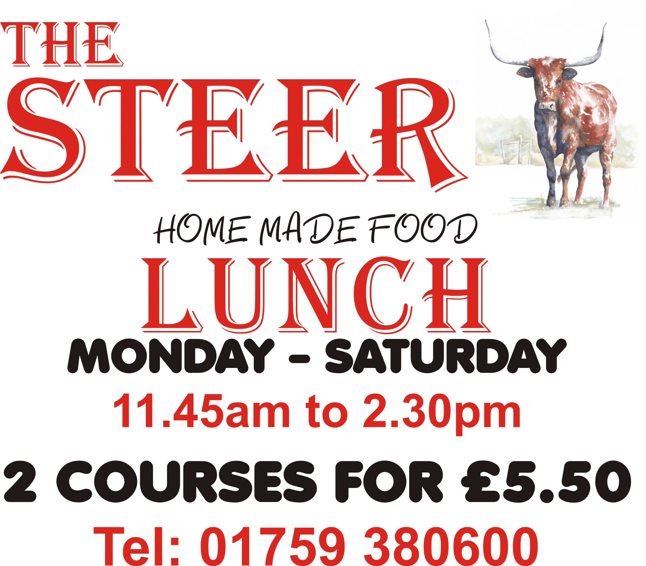

    Hi all, just a quick one, should be simple but i am having some kind of block…
    All the info is there just need some advice on design improvements or layout.
    Cheers for any help or advice offered
    stephen
    Simon Strom replied 18 years, 2 months ago 9 Members · 18 Replies
  • 18 Replies
    11 September 2007 at 20:54
    sorry don’t how to post it open for view
    11 September 2007 at 21:01
    Here’s a suggestion, but it may be too "American".
    11 September 2007 at 21:04
    sorry to be so blunt… but needs a fair bit of work mate…
    "the steer" means nothing to me… needs to look separate from the rest if its the business name.
    text needs room to breath. needs to be better laid out so its easier to read.
    zero space at left and right of sign blank etc etc
    ide suggest grabbing all the text and dropping it to 80% its original size, then trying a reshuffle on layout and colours.
    the font is too bland. if its a traditional type place, use a traditional type font and so on…
    maybe try introducing some pictures of food etc…
    hope this helps a little…

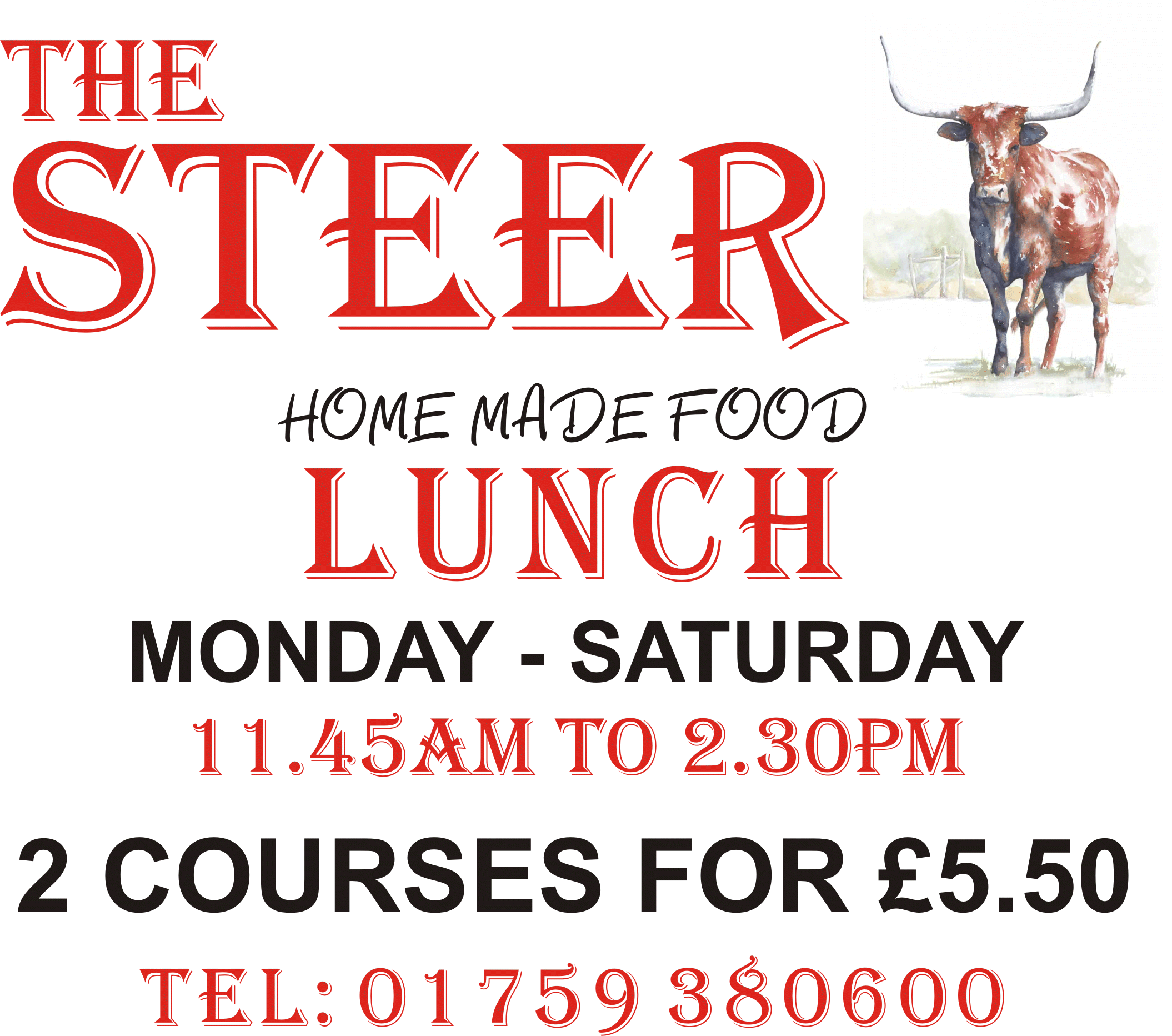

    11 September 2007 at 21:12
    Shuffled around a bit – kept it basic.
    Quick & easy as it’s a bit ‘vague’.
    Is it themed? Maybe introduce a western (like Jill’s) etc.
    Colours? Not a white background, basic clipart.
    Go cream & brown for example.

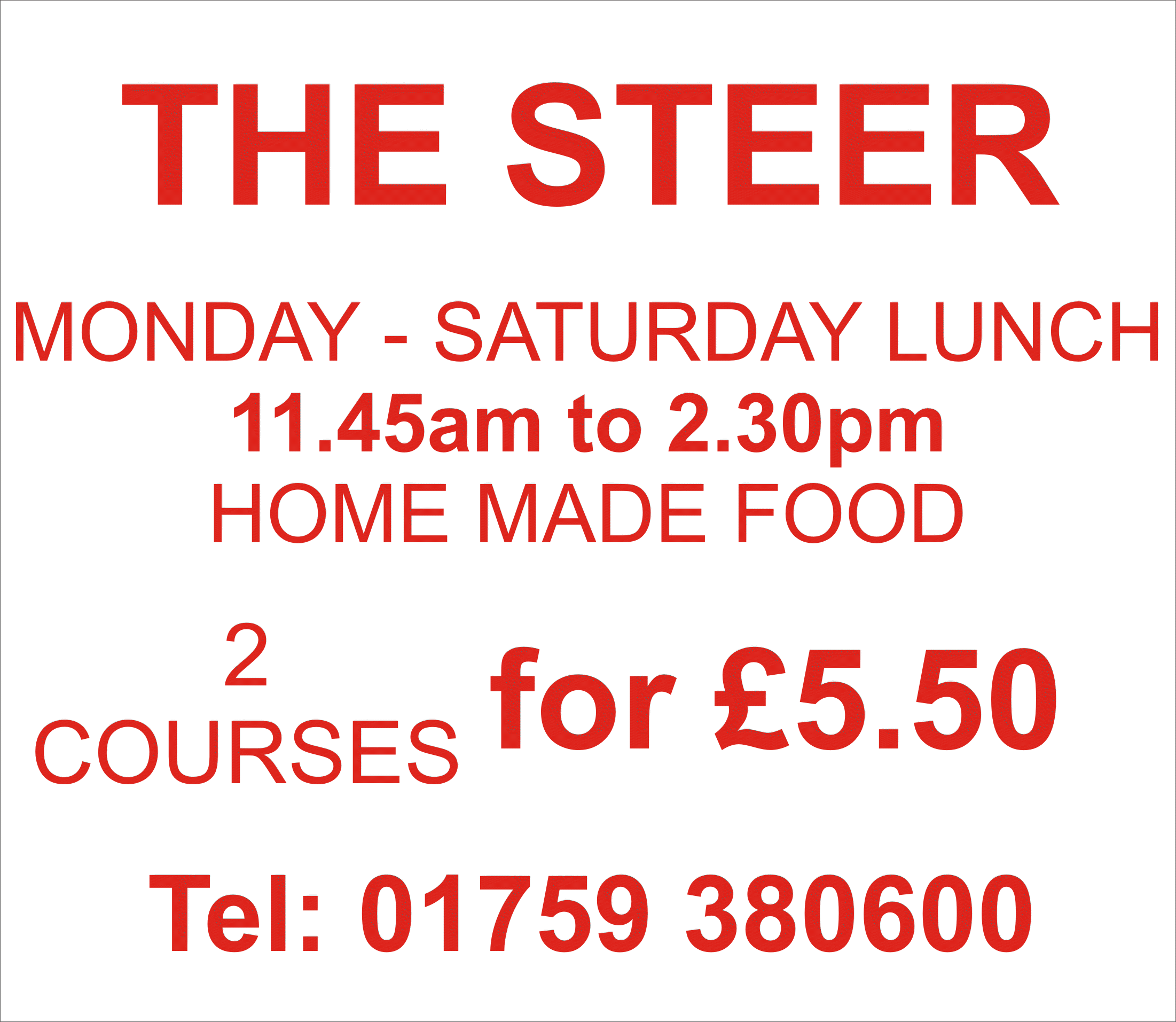

  • Stephen Ingham
    11 September 2007 at 21:48
    hi all thanks for the quick responses
    heres another one i was working on..
    cheers
    stephen
  • David Rogers
    11 September 2007 at 21:56
    Too many font…too cramped at the bottom.
    ‘THE STEER’ works in the ‘Algerian’ font – the ‘vag rounded’ does not. It’s just not ‘complimentary’ to the theme or any other the other typefaces.
    Open it up (more space) – and step back a few feet from the monitor. What do you WANT to stand out?

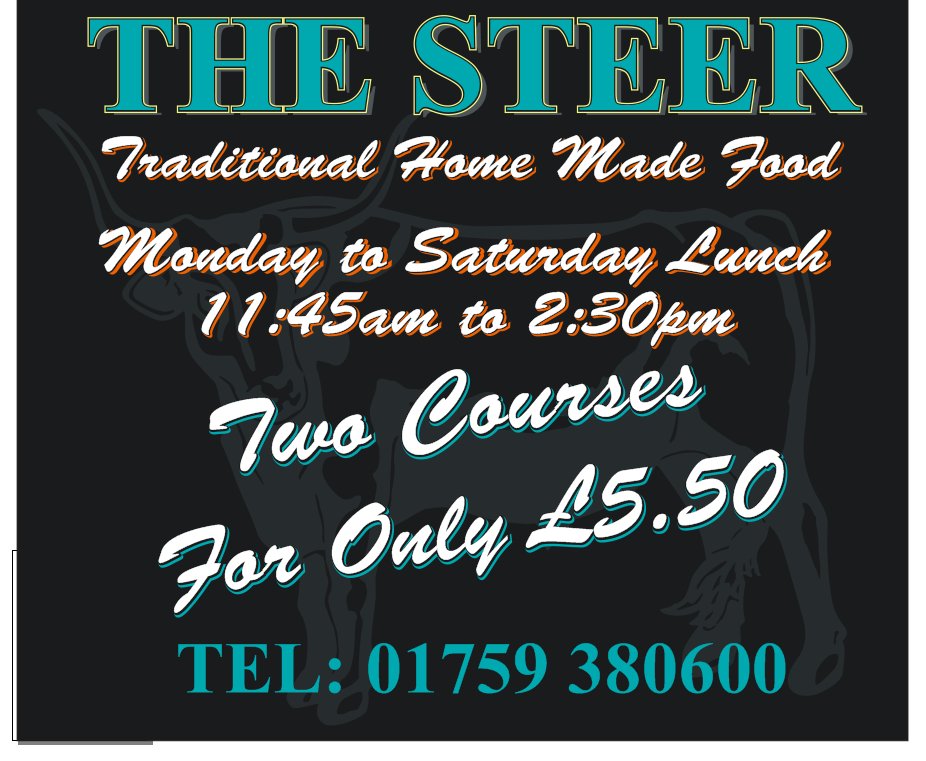

  • Stephen Ingham
    11 September 2007 at 22:04
    hi, is this any better??
    cheers
    stephen
    11 September 2007 at 22:06
    What size is this sign?
    Where will it be located, viewed from?
    i.e. on a wall on location, viwed up close, road end to catch passing traffic etc?
  • Stephen Ingham
    11 September 2007 at 22:12
    hi robert, we are only supplying the sign and not fitting, but i assume it will be going on a road edge.
    it measures about 1220 x 1400mm
    cheers
    stephen

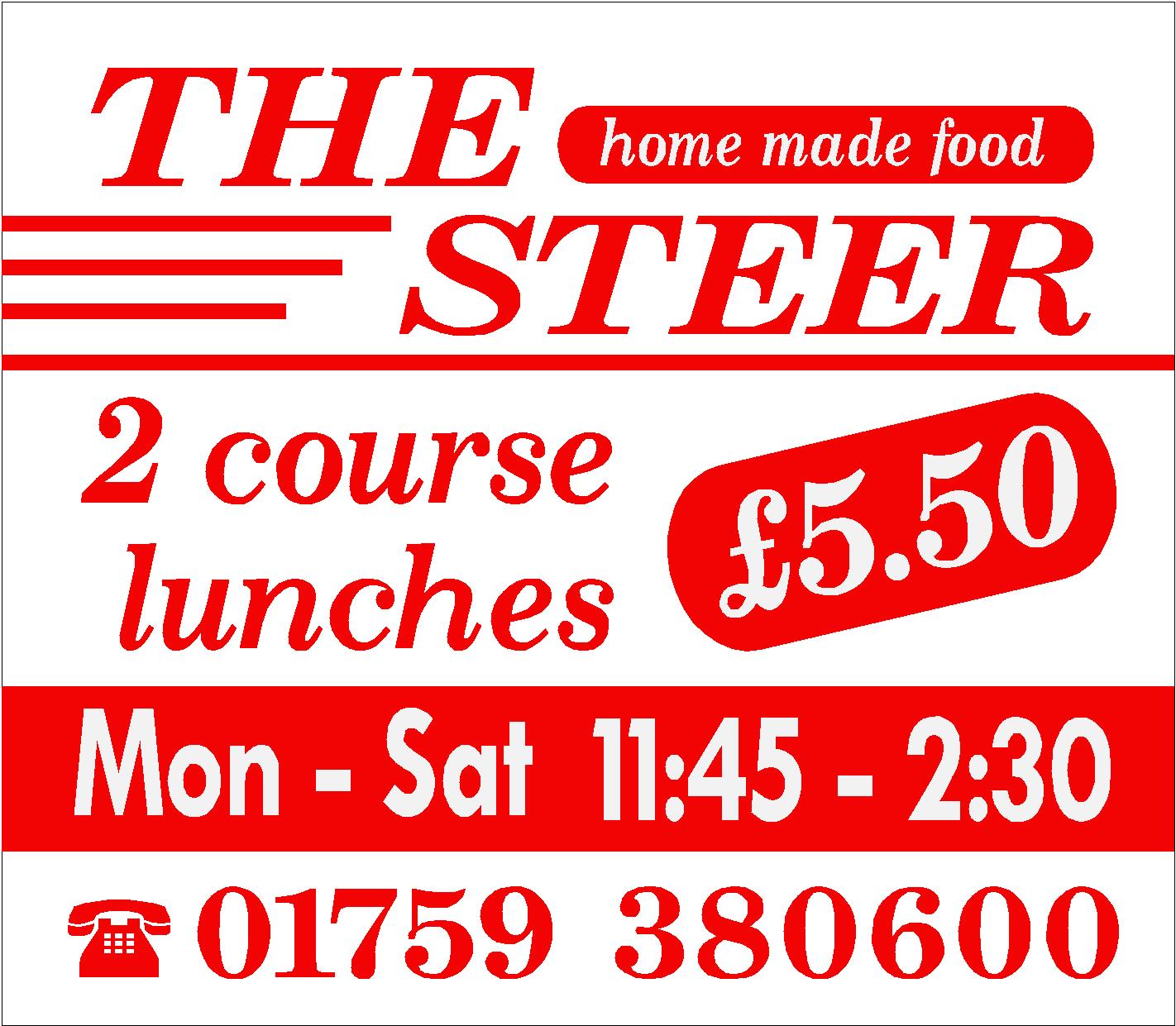

    11 September 2007 at 22:34
    ooh, lots of posts while i messed about with my idea, i’m not overly keen on the colours i’ve used, they just kinda worked together ok(ish),
    i would prob get as far away from plain red on white as possible, just too harsh imho, the sign needs to attract the interest of passers by, and be inviting,
    anyways, forgive me for my efforts !….. 😮

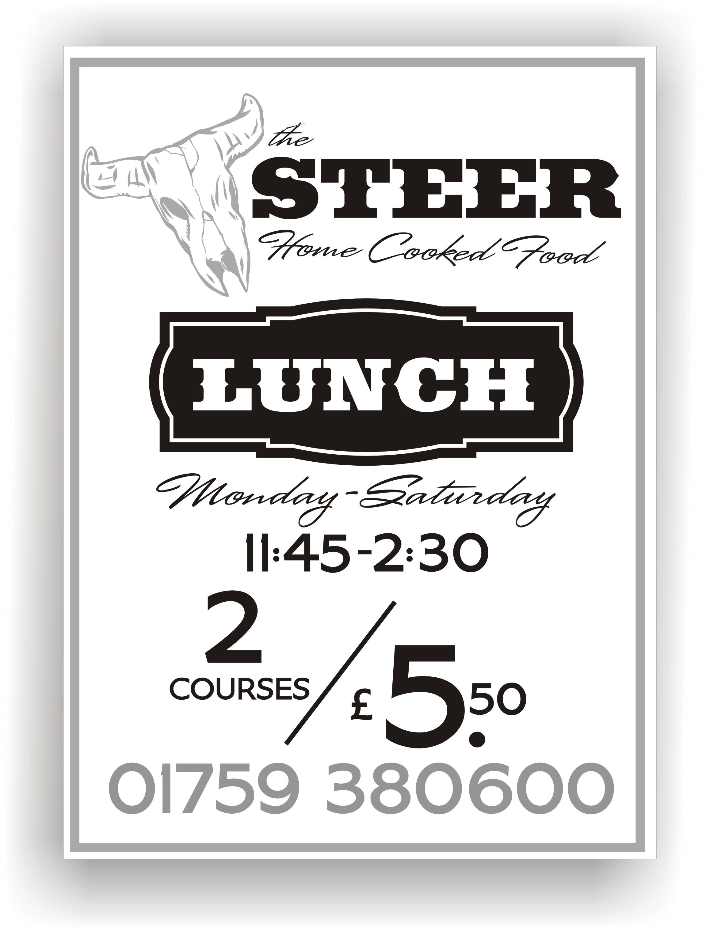

    11 September 2007 at 23:49
    Please excuse the lack of fonts and design layout, as i am using photoshop only and limited to fonts and capabilities using this software. (i prefer signlab) But thought ide try and show a simple layout i have done that i think is easier on the eye and still manages to get the message across.
    well at least i hope it does… :lol1:

    12 September 2007 at 09:40
    hi stephen
    ive no problem giving you the images mate but i only have them at around half a meg. so maybe not the quality you will be after for this job.
    that said, the three of them are on istock.com at various qualities.
