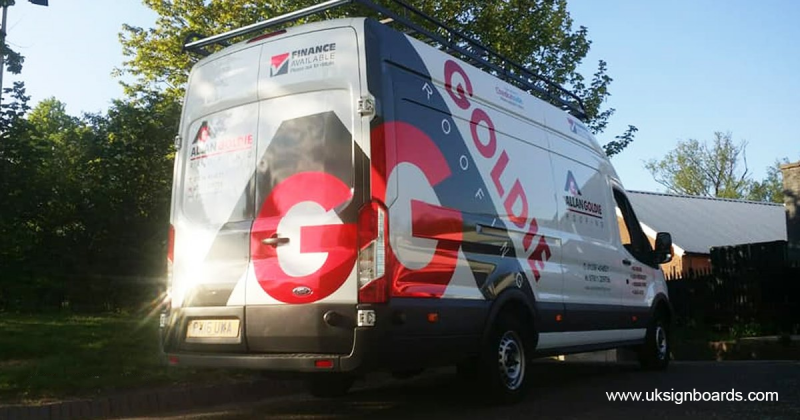

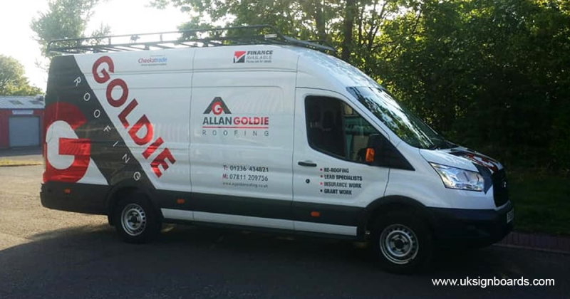

    1 February 2022 at 20:52
    It’s fine to cut wrapping vinyl, with the limits being what has already been said above.
    Below is a van I did using oracal cast metallic grey and Avery Supreme Chrome Red wrap to cut some of the graphics and text.
