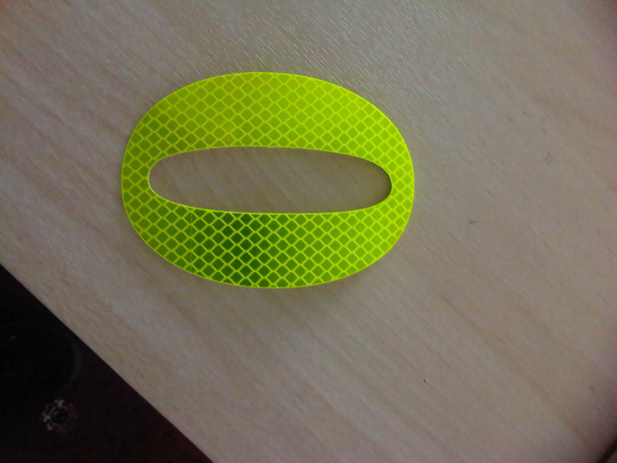

    Finally! I have sussed it!
    1.) get a 60 degree blade
    2.) get a good visible point on your blade holder
    3.) set speed to very slow
    4.) put vinyl in upside down ( white facing you )
    5.) in your program copy and paste the cut file twice, so the blade will cut twice over each letter
    6.) work in small areas at a time for accurate registration
    7.) send to cut
    8.) after cutting, push through letters. Might need a little scalpul work on fancy corners
    9.) perfect letter shapes
    Oh btw CUT MIRROR IMAGE lol

    UPDATE:
    To avoid track marks on the face of the vinyl, put application tape on the face. I have just tried cutting some large text using this method, and solved the track mark problem
