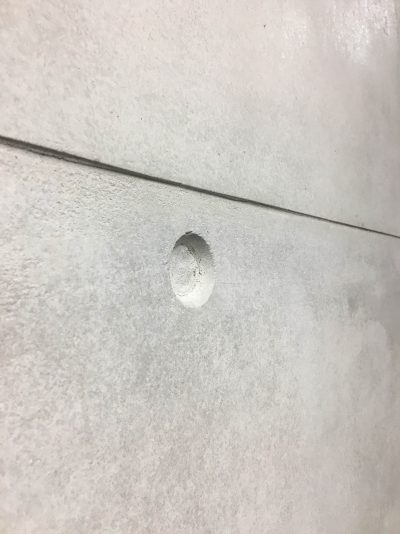

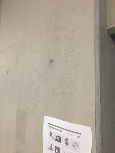

    Had the meeting this morning, and the walls we’ll mostly be dealing with are cast concrete – smoothish, but with little voids apprx 1-2mm, and odd raised grains here and there. Doesn’t seem to be a problem with things sticking to it (selotaped A4 posters here and there).
    I’d like to go down the cast route but am having trouble finding anything other than black and white in a matt finish (except wrap vinyl that won’t fit in a 24″ plotter, and costs rather a lot). The decor is mostly muted greys / pastels, and part of the job would be text/colour coding different zones of the floors – three of the floors are effectively hot desk. I get the feeling that some areas will shift purpose over the years, so a vinyl that has a fairly clean removal would be an advantage.
    Hopefully a very rough draft of design will be with me next week, at which point I’ll order in a test roll, and see how I feel about the time scale (quote) for production and install.
    Pictures attached – I’ve spoken with the designer, and we’re going to avoid graphics over the casting holes (apprx 35mm diameter, maybe 8mm deep)!
