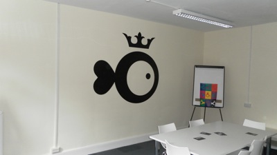

    I have done quiet a bit of cutting on my sp540i and have never touched any calibration settings since getting it a few months back and cuts perfectly, the attached fish was 1180mm top to bottom, the crown was done separately and it was spot on.
