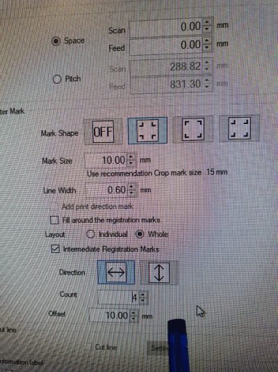

    Add more crop marks in Rasterlink (select whole, check Intermediate Reg Marks, up the count to suit) and a bleed in Coreldraw if the design allows.

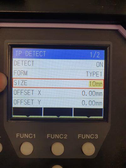

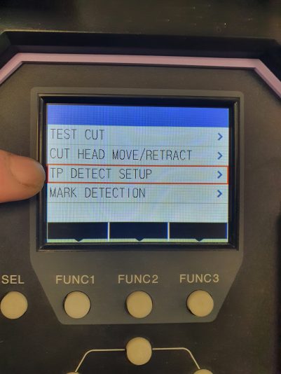

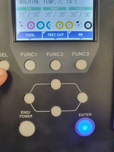

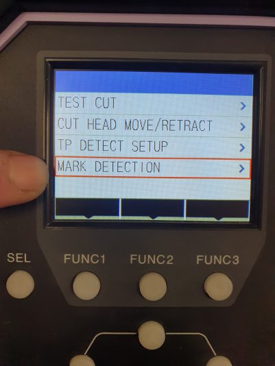

    Do you match the crop mark size printed on the printer in cut settings before cutting?
    Press Sel until you see TEST CUT follow the phots….

      Thanks so much for your reply.
      Yes I do all that, I think the problem is when putting the trace line on in coral draw, its out.
