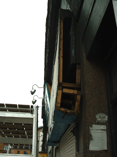

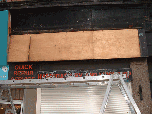

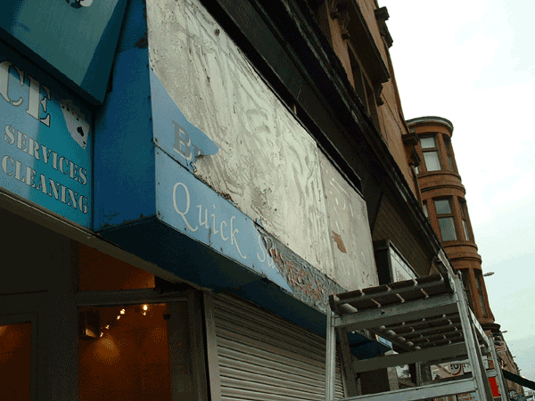

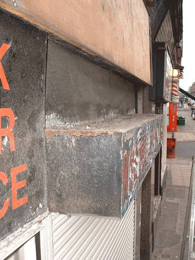

      Basically, the spec I had on this job was simple.
      Arrive with 3 di-bond panels, measuring about 75 inches high by about 52 inches wide, & fit them to a wooden “existing” shop fascia.
      I was advised by the customer to take some tools to remove some old Foamex but to then simply silicon and screw the panels to the face of the wood. Easy! Or so I thought.
      It’s always the same…
      a customer will play down the work to save some cash! understandable but this one pushed their luck a bit too far.
      Anyway… I arrived on site… looked at the job and thought fur-fu**s sake!
      I removed a large V-shaped For Sale Sign.
      I then removed a Foamex sign.
      Below that was another thin plastic sign. So I removed that also.
      When I did, the whole thing started to wobble and was clearly unsafe…
      Outcomes the owner and I explained… “unless I rip this down it’s gonna kill someone sooner or later.”
      He gives me the nod and I carried on. Down comes the sheets of ply to expose. Yet another sign!?
      I take down that sign and you guessed it another sign!
      This time when I removed that one I actually found the signs backing board was in pretty good condition and it was fitted very well. so I thought I am far back enough, so I will have to work on this!
      As I pulled some bits away to the side I spotted behind that backing board was another sign!!!!
      As I laughed I said to the guy with me, “that’s number 6!”
      He said, “no chance!”
      So I put my hand in and pulled it forward to show him what was behind it. as I did he said, “you’re right, but look underneath that bit you’ve pulled up” Another sign!!!
      This time painted on the marble building and must have been at least 100 years old if not much more!
      7 bloody signs all on top of each other. this was my first time ever seeing something like this.

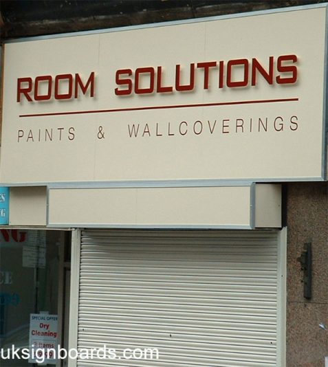

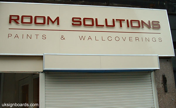

      Anyway… after getting the lot back to something more secure to fix to I went about
      Making a new frame to build onto the old one.
      I cut up the large di-bond panels to create a sign but not as deep.
      I used the off-cuts to box in the old shutter box, which was now exposed by me ripping the frame down.
      I edged the lot in a 1×1 inch aluminium angle and applied the flat cut letters.
      You will see some, but not all the stages…
      This was a bit of a nightmare, to say the least, but in the end, the customer was thrilled.
      My hands were cut to bits but I was happy enough with the result.
      Below are just a few pictures taken during the install from 2004.
