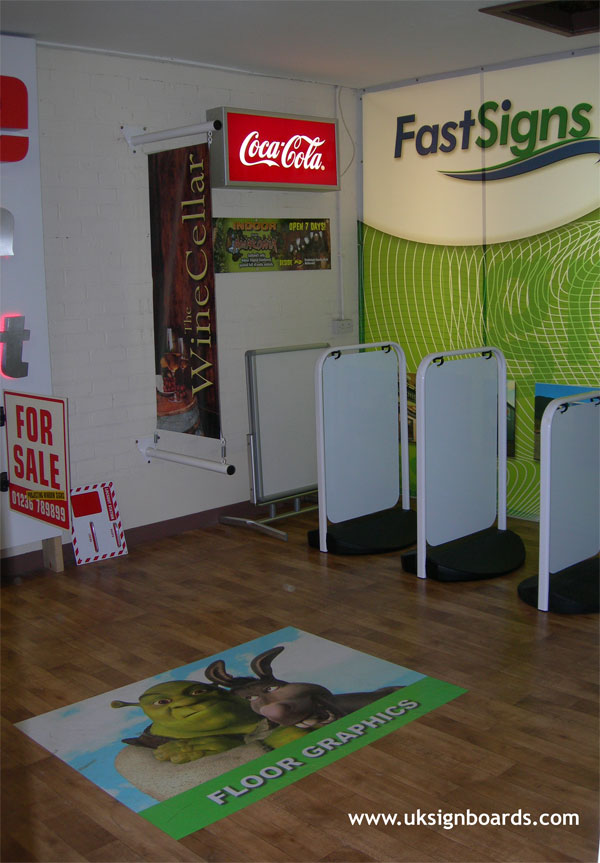

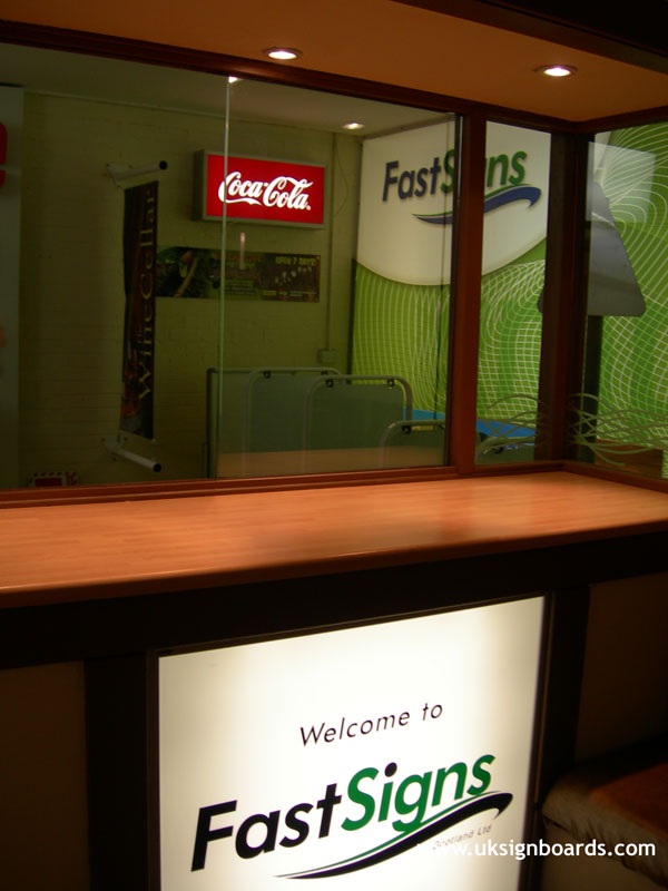

    5 July 2007 at 23:06
    hi paul
    yeh that’s exactly it mate… that is actually what i did in our showroom im putting together (if i ever get round to finishing it) :lol1:
    the picture below isnt the best as its taken from inside the reception office. but you can see the back illuminated wall?
    what i did was i used two x two wood batons and screwed to the ceiling with one and the same on the floor. i made it about 8inches from the wall.
    the reason for this was to allow me to screw some OLD fluorescent lights to the wall. 6 in total along the wall. i then printed onto back lit banner material and rigged the fluorescent lights to the lighting so when you turn the lights on in the work the wall illuminates also… its pretty effective and hides an old rough stone painted wall behind it…
    its actually going to be changed as it was thrown together to hide the bad look of the wall when we began changing the offices around…
  • David-Foster-
    6 July 2007 at 11:20
    10 out of 10 for that one Rob. Great idea, I can see me suggesting something like that to the Mrs when it comes to decorating 😀
  • Martin Cole
    6 July 2007 at 12:40
    I must say that is very effective Rob, very nice.

    6 July 2007 at 14:18
    That’s brilliant! I especially like the backlighting idea. So many terrible walls need never be seen again.
    Well done sir.

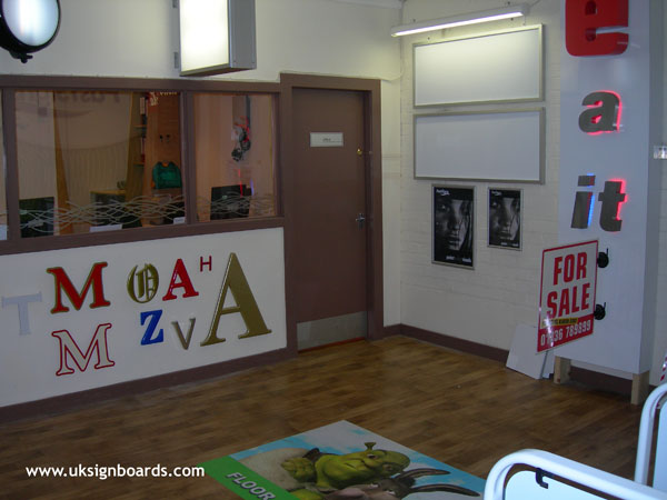

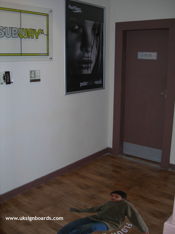

    6 July 2007 at 22:26
    found a few more pictures but at different angles. these were taken a few months ago so much less done/content than there is now… ill get some good pictures once its finished. "if i ever get it finished…" 😳 :lol1: :lol1:

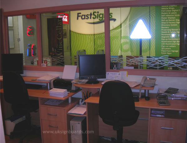

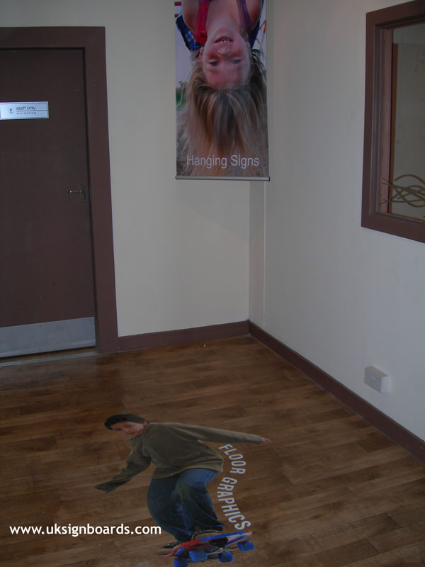

    6 July 2007 at 22:44
    this is the last two mate… as i said, these arent recent so still rather bare in places. once im done with it and the other areas of the work too ill get some decent ones loaded. 😕 :lol1:

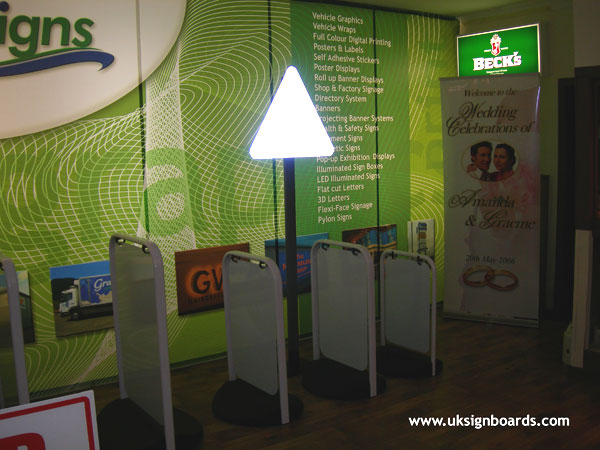

    6 July 2007 at 22:49
    thats them all now. :lol1:
    as you can see, lots of the signs dont even have graphics on them yet 😕 :lol1:
