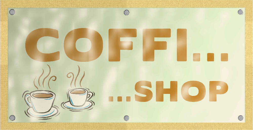

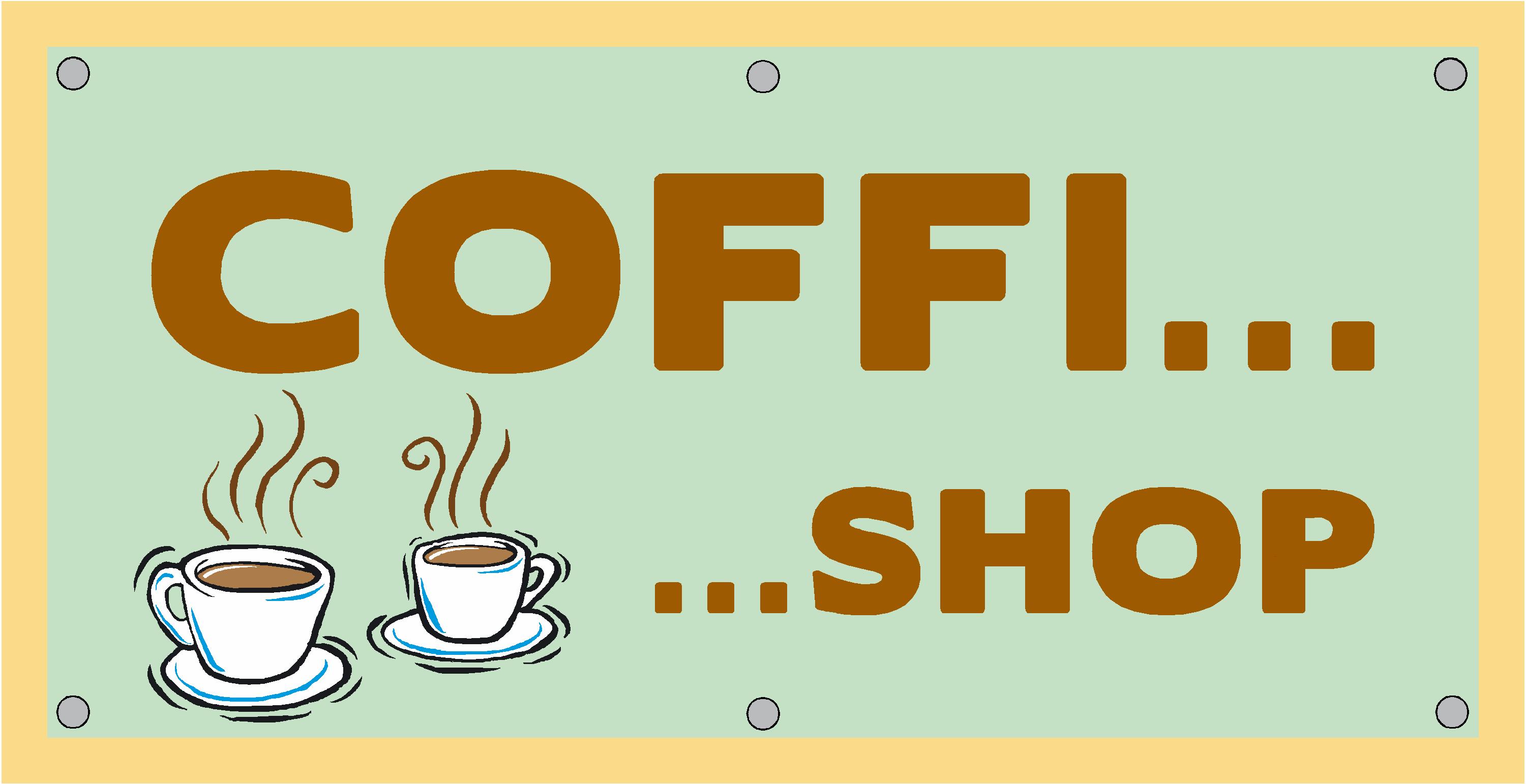

    i have a coffee shop to kit out.
    i have a design made up but i can’t really get the affect as it would look in real life.
    here’s what i want to do
    3mm alupanel flood coated creamy colour
    40mm stand-offs with clear acrylic.
    not sure with the font yet

    I know this is probably none of my business but coffee is spelt the Welsh way (coffi) but shop isn’t (siop).
    The design looks good to me though! I dunno if you’ll ever get the ‘real life’ effect you want on 2d media.

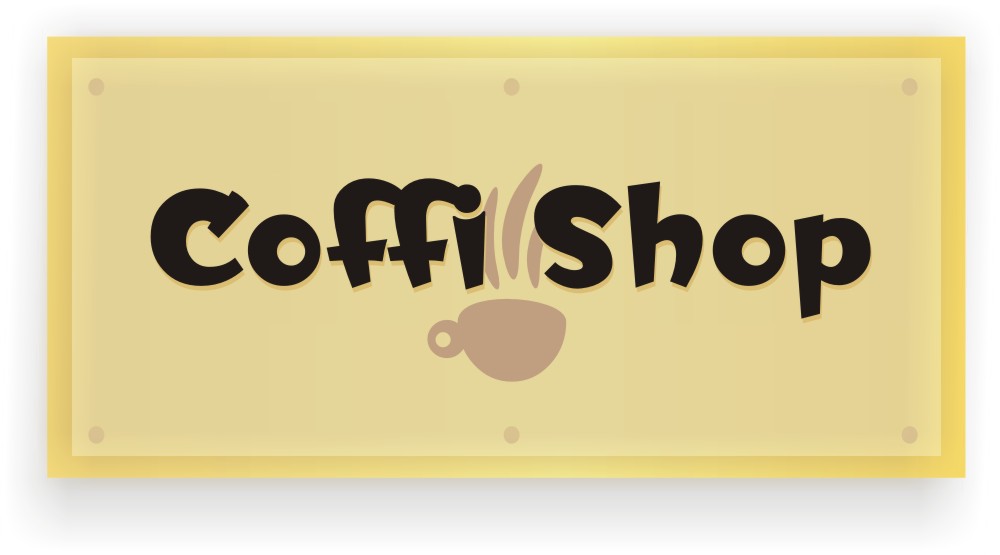

    I might try this:
    Spell Coffee as it should be with just a capital C.
    Lose all the dots.
    Re scale SHOP.
    Use brass coloured stand-offs.

    Would just say – use as thick a cast acrylic as you can sell / customer can afford. Apply to the reverse side for a better effect – but this can create reflection problems. Watch out for any separations / overlays in the cups.
    Flame polish the acrylic edges. As already suggested, maybe lose the ‘…’ and replace them with a swirl(?) if not integral to the design and switch to brass coloured standoffs.
    Overall, I think it looks pretty good & has the potential to be a pretty classy piece of work.
    Had a wee play with a glass effect…just for fun.
