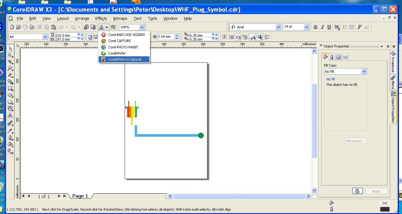

There doesn’t appear to be any drawing in the attached file………what version of Corel are you using, for some strange reason there is an image in the thumbnail.
Export from corel as an AI file then import into signlab,
or just drag and drop from corel to signlab, or cut and paste. there is also a corel to signlab button that can be used but it needs to be set up from the folder containing signlabPeter
