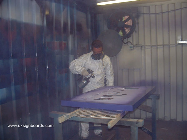

    i have had two for the past 5 years.
    one i converted into a router room with split wall/door to house the computer terminal. keeps it out of the way of dust and waste coming from the router. its fitted with 3 phase electricity also.
    the other a spray booth…
    again it is split by a partition wall… one side has sink, compressor and shelving with a small hole in wall to feed air lines through for the guns.. the other is a clear area to spray signs and panels.
    we have a large extractor fan fitted too as you can see behind me in the picture below.
    both these rooms take a huge chunk of all the crap from our workshop as both create such a mess…
