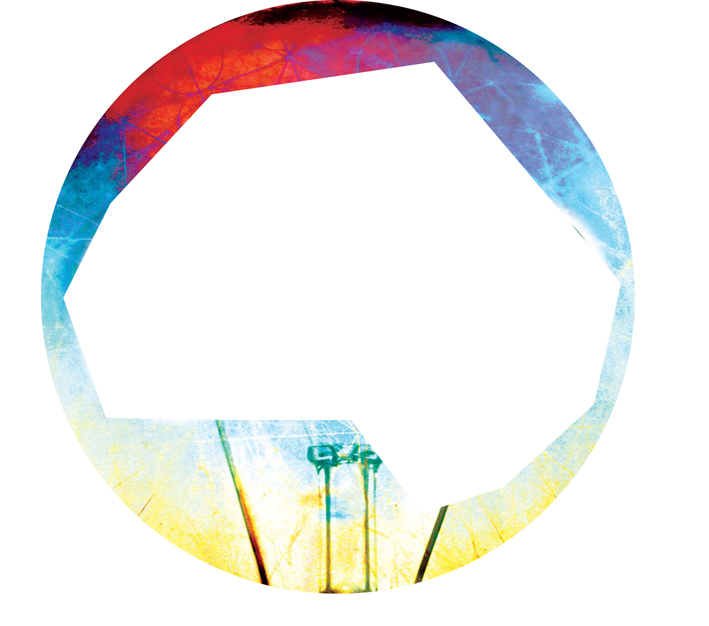

    Thanks for your answers. So if the client has a logo which he has had designed. A circle logo which he wants contour cut. He has the artwork but it has no bleed.
    What is my best option on a 50cm logo.
    Sacrifice a couple of mm of the logo to act as the bleed or is there any way of adding a bleed to a multi coloured logo, any kind of cheat?
    logo added to explain what i mean (sorry for removing company name)
    Liam
  • Warren Beard
    6 September 2010 at 14:29
    just increase the image to 504mm with a 500mm cut line
    job done.
    warren
  • Liam Pattison
    6 September 2010 at 14:41
    quote Warren Beard:
    job done.
    warren
    Thanks for that, i’ll try that
