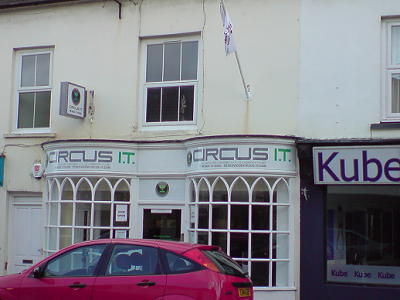

    it will bend, these were 8-9ft long and 300 or so deep…

    yup they will bend easily I did similar to hugh fix one end top and bottom then bent round and fixed the far end dont worry 😀
