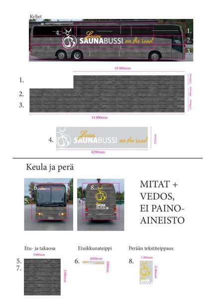

    Hi guys, ive had a quote request for a coach wrap. Tbh this is a mahoosive job for my little outfit and want to try and get my head settled on how i would tackle this.
    So your thoughts and opinions are welcome as im sure many of you do jobs like this in your sleep.
    So material wise i was thinking IP 2d cast wrap film (maybe a little OTT on the sides but it would make it easier to fit.
    Fitting is on my own. Sides i would do bottom quarter 5m lengths 1200mm high and vertical joins would sit in the storage flaps which cant be seen in the pic. Above this there is a 50mm rubber which goes the length of the vehicle. Then the middle would be fitted same way but as there are no breaks in the bodywork there would be two overlap joins, then fill in the top with the same method. Logo and text would then be fitted over the top in polymeric vinyl.
    Back fitted with horizontal joins, 3 pieces starting from the bottom.
    Now pricing wise – in the past the larger the job i have lowered my material charge and priced tightly on hours. But i have learned that this can bite you in the arse and you can be chasing your tail.
    It looks to be around 70-80m print @ 1370mm.
    Fitting time im thinking of going on the cautious side, 4 days.
    Obviously the pic doesnt show all the details, lights, handles etc etc but as with all coaches they are there.
    Be happy to hear from you.

    Hi Martyn, I completed a job similar to this. We did a two man team and worked through the night and it was back out the next day! Apparently coaches are rarely turned off. The sides are really no problem, grills are the nightmare as they have many slats etc for cooling or venting. Only thing that would have made it easier would have been to use air release this would have just sped up the process. We charged £3700+vat but included driving 6hours each way to the coach. Don’t know how that aligns to others but worked out our cost per meter / time / travel ‘ fuel and labour. I also took into account not being productive for a couple of days after! Hope this helps.
  • Chris Wilson
    6 October 2020 at 19:59
    Done the backs of these last Christmas. The trim is a pain. I didn’t think they would take as long as they did. Had a 5m x 1m bit down the sides of them to. Was a day a bus of hard graft up and down the scaff tower. But these are old things, your coach looks much nicer 😂 Make sure you have plenty of scalpel blades to Hand. 4 days sounds good to
    Me but I would tell them 5. Maybe am just unfit but I feel tired just looking at this photo again.
    Pretty sure metamark have a “bus wrap”.. don’t know the details but I mind seeing it on printmax once and it was cheap for a roll.
    7 October 2020 at 02:18
    Hi Martyn, thanks for contacting me. Thanks Martin Cole for the nice words. Long time no speak. Hope the family are doing well.
    Martin, I’m not familiar with IP2D but would be using an air release adhesive as a priority so you can do it dry. You have the correct idea of using the natural joins to hide the overlap, but, doing it in such long lengths can cause some problems. We usually limit the maximum length per horizontal panel to around 4 mtrs when doing it by ourselves. We then hinge in the middle giving us a 2 mtr length either side of the hinge. It’s easier this way when working around wheel arch, lights and handles.
    Fitting could easily take one person four days with cleaning, removing ancillary bits and bobs, fitting and putting everything back.
    One tip worth noting is to work from the back to the front. This hides the join from the weather as the vehicle moves forward, stopping the weather from being pushed into the overlap. The cut edge will be facing the rear then.
    The same applies from bottom to the top. Start from the bottom first. This allows the join to cover the length below and stops moisture from sitting on top of the overlap.
    You sound like you have thought it thru pretty well. I’d just hesitate doing it in longer horizontal lengths working on your own.
    Hope that helps.
