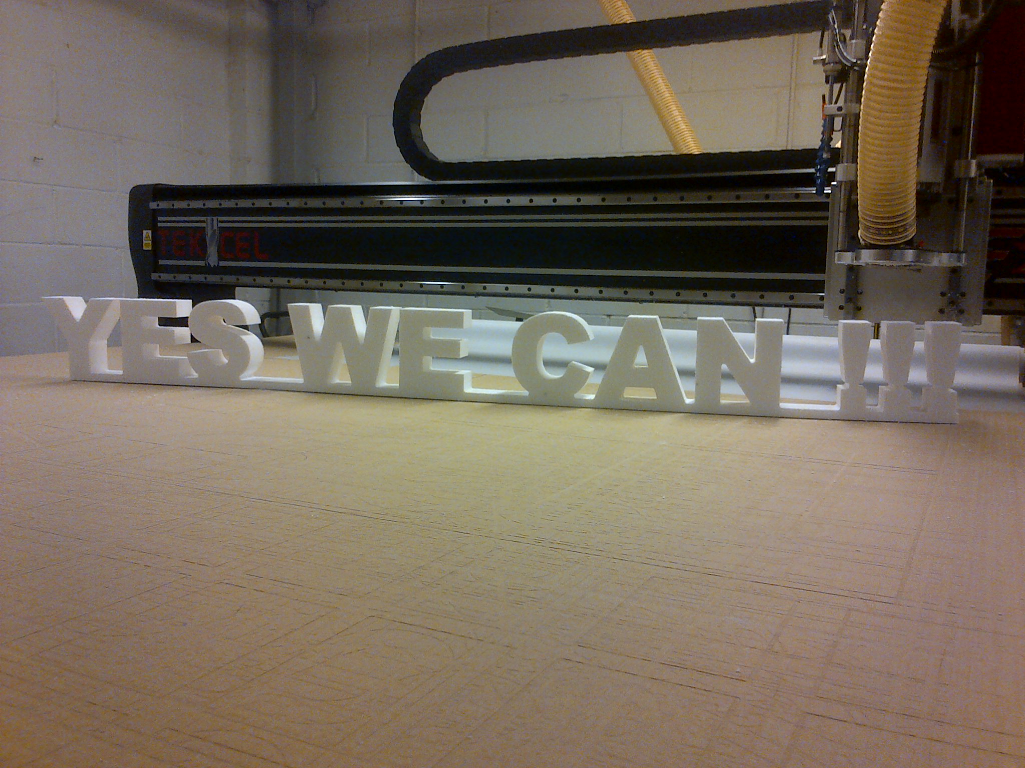

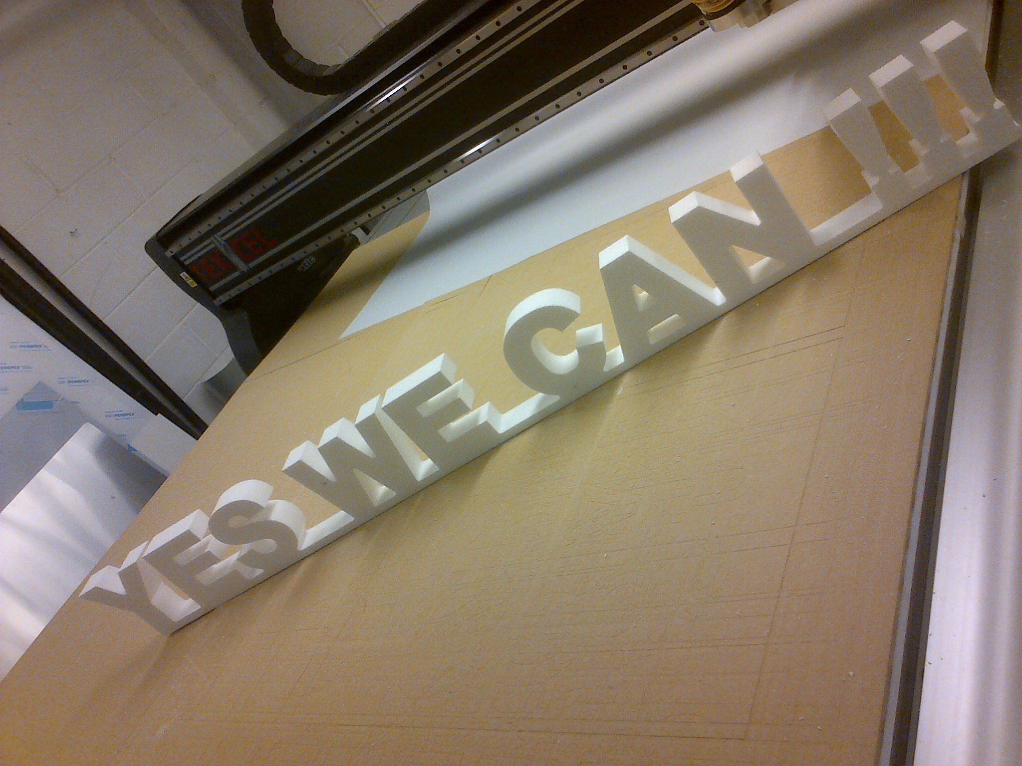

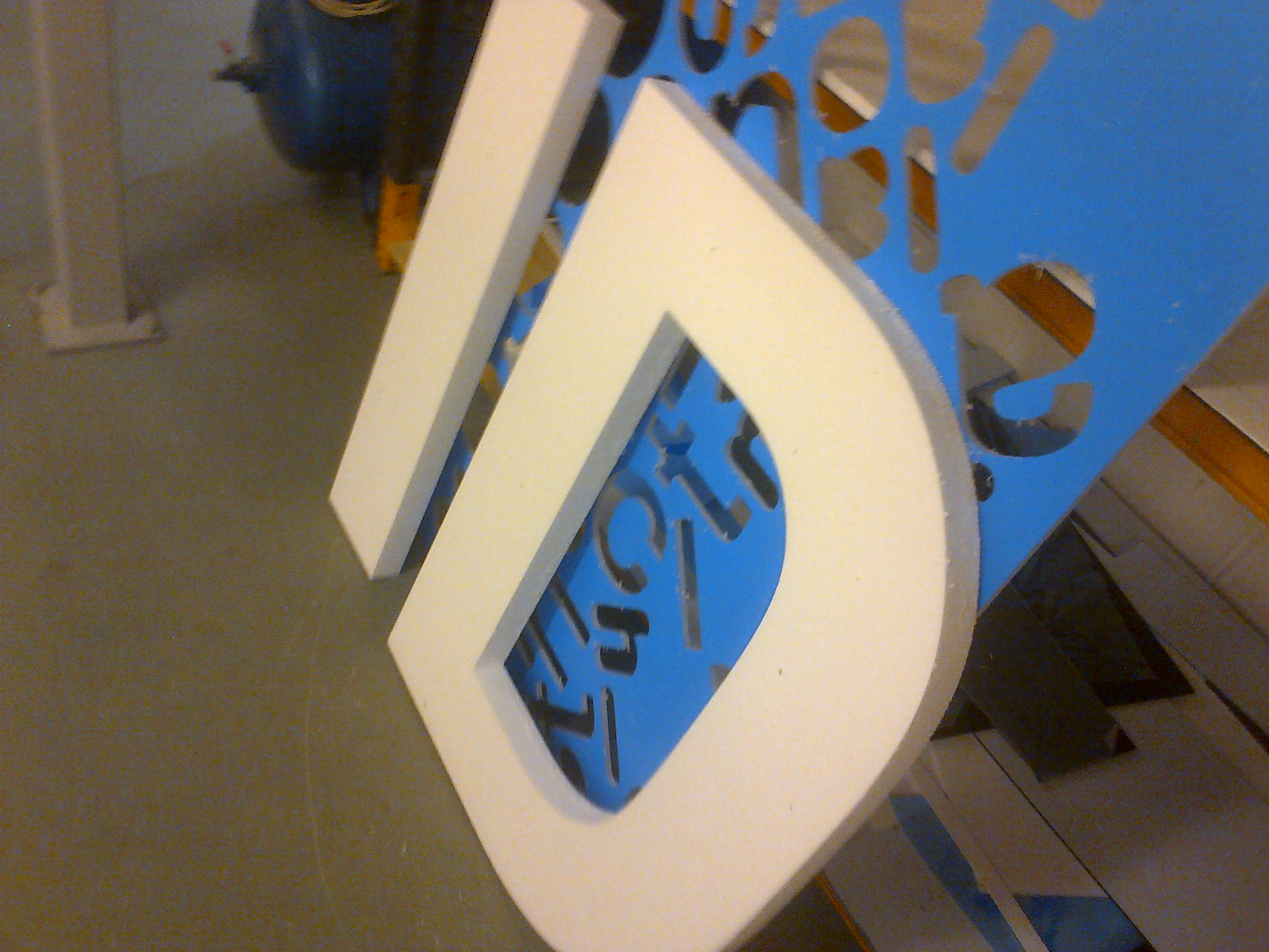

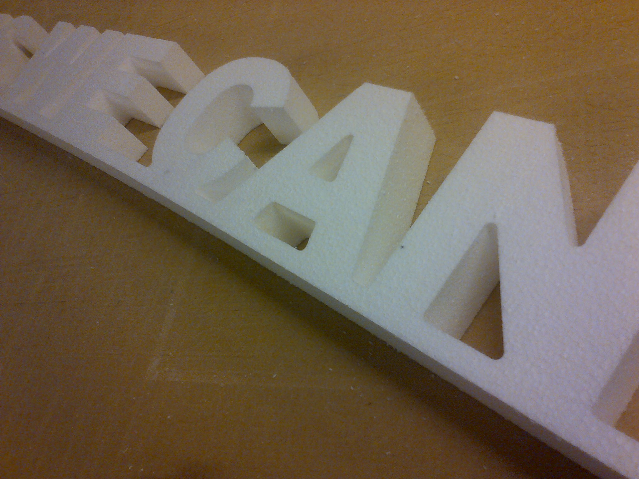

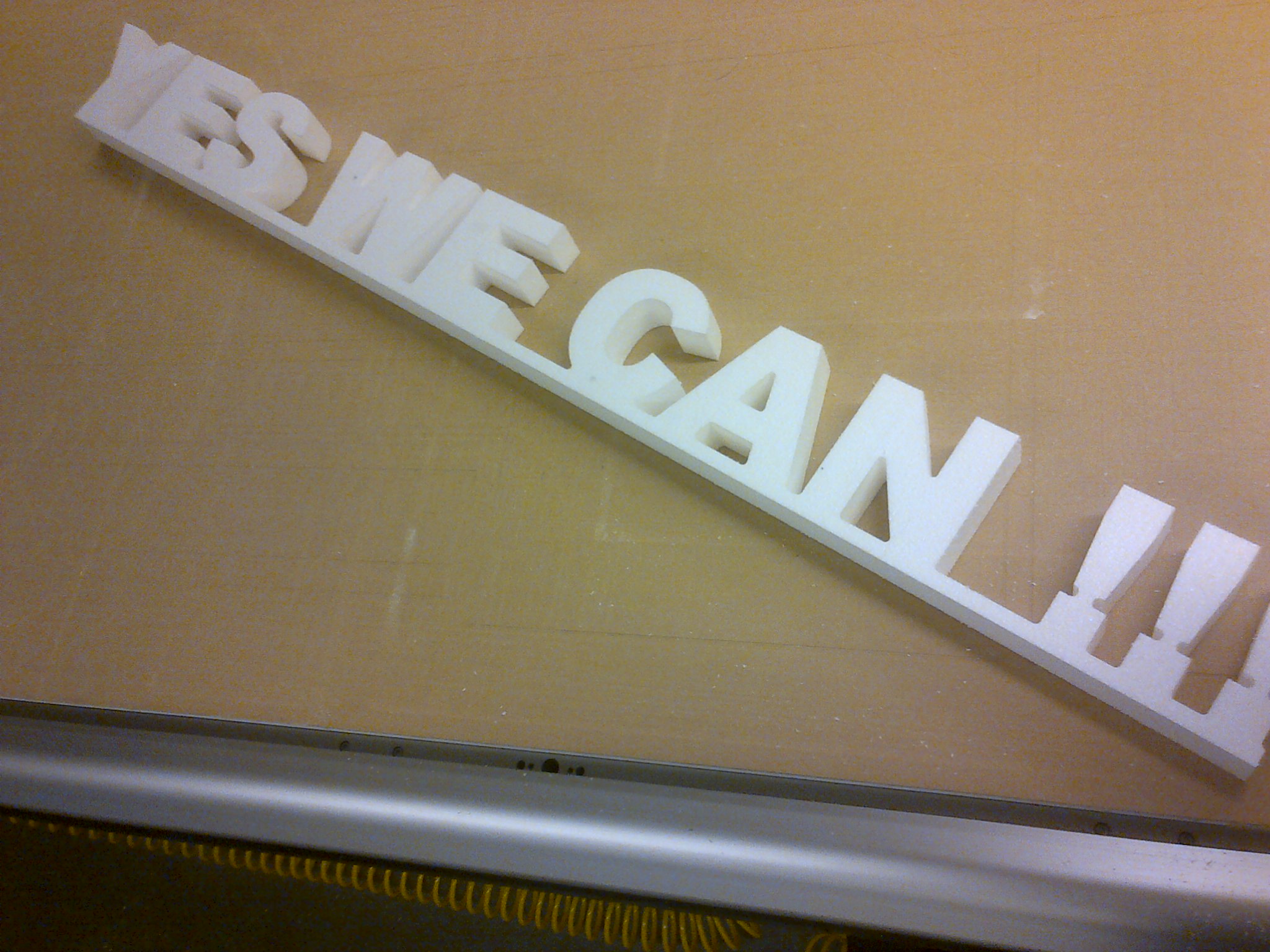

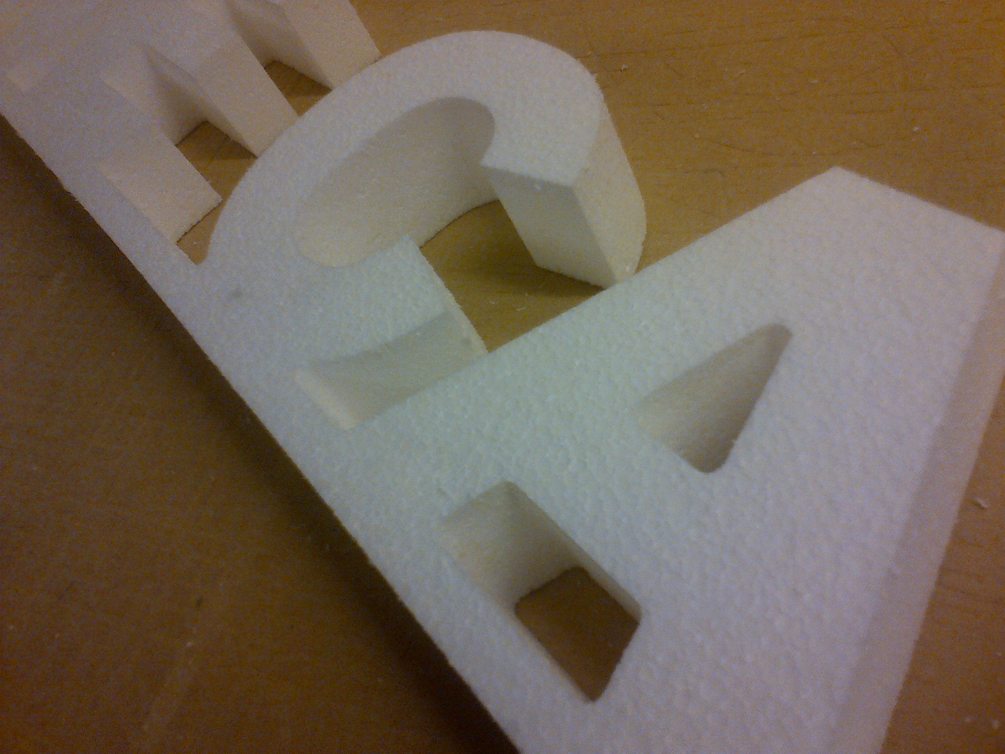

    Ok so here is an update on how this turned out!
    As you can see the results were fantastic…We even did a bit of engraving, the High density polystyrene worked a treat!
    Thanks to Jeff @ CNC POLYSTYRENE for supplying us with the material – Well worth the 200 mile run trip, our local supplier couldn’t get it to us till Friday and we needed it today.
    The samples we cut were done in 2 passes using a tool purchased from complete cnc solutions (Tekcel)
    hardly any mess at all the dust extractor worked a treat.
    As you can see from the pictures we cut some small text and some 1.2m letters in the last picture.
