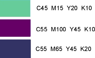

    Hi there,
    could someone explain how to find out the pantone colours from the CMYK details given to me from the designers.
    I need to match vinyls to the clients specification.
    I’ve bought a brand new set of pantone guides, but can’t seem to find what I need. 😮
    The numbers are:
    C45 M15 Y20 K10
    C55 M100 Y45 K10
    C55 M65 Y45 K20
    I’d appreciate knowing the pantone colours, but would be even more grateful to know how you got to convert it so that I know next time.
    Many thanks,
    Cheryl 😕

    Have put in your CMYK values – and the blue, purple and grey(?) ones come out at 570C, 2603C and 668c respectively. It does say that all three are not a complete match – the blue is a closer match than the others.
    Guess you have no option but to double check but at perhaps this will give you a starting point.

    many thanks for your help. You’re not far off with a couple of them. The pantone numbers check out, so thanks very much.

    just print cmyk values cheryl, you dont match it to pantone unless you have been told to.. if you need vinyl then print 5mtr block of that colour then feed it into your cutter and treat it as oracle vinyl if you cannot vinyl match it.
    CMYK values are printer values so thats the most accurate way of getting the right colour.

    right I’ve printed out a sample of each colour. They look ok and I’ll hopefully match them to a vinyl thats close.
    The top one is a blue/grey, then a burgundy and a sort of burgundy/purple.
    If all else fails and the client is picky, I’ll do as Phill and Dave suggest and just print the graphics that I need.
