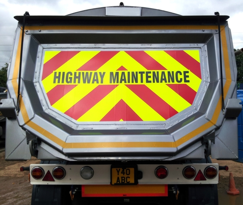

They supplied this custom shape. The yellow was in 2 halves with the red parts all individually added afterwards. -

They supplied this custom shape. The yellow was in 2 halves with the red parts all individually added afterwards.Hi Peter
You’re right regarding the Chapter 8 as it requires class reference 2 or higher which in most cases it’s a prismatic reflective product, but I think you might be mixing chapter 8 and ECE 104 up.
Chapter 8 is the 150mm wide class ref 2 reflective chevrons placed on an angle of 45 of 60 degrees. If its for an escot vehicle these dimensions are different.
ECE104 is for all 7.5 tonne plus vehicle registered after July 2011 and yes the reflective tape used for that MUST be stamped.
Some are rules some are guildlines some are best practice…….all confusing 🙄
