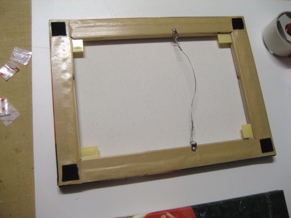

    Hey neil,
    Here is the back of the frame.
    Corner wedges (perfect drum like finish and customer can adjust over the years of the canvas sags), frames tape, d-rings with screws (so customer can adjust height on wall themselves, bumpons (velcro not to scratch the wall).
    25 December 2007 at 12:57
    thanks for the picture jason, ive made my own frames and also print via our grenadier with solvent inks onto grafityps canvas. but our frames are very basic and not much thought into them. thanks for the tips mate. 😉
    Just wondered how long you expect the print to last jason?
    oils on real canvas may well need a stretch after a few years, but print on synthetic? hardly likely, most of the media is stable as far as "sagging" goes, but the ink will fade long before the media needs adjusting will it not?

    I supply a few portrait studios. All prefer to have real stretchers and wedges. If the canvas sag its easy to just tap the wedges, otherwise its a complete redo.

    Hey Peter,
    Even during the framing process the wedges help you achieve a perfect drum like finish easier. Its good to be able to tap the frame out a little bit to make it tighter.
