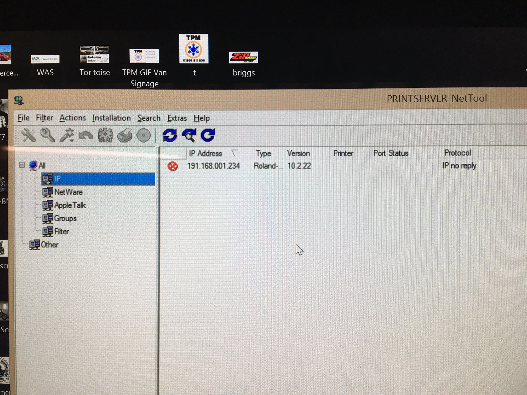

    I tried to search for printer and came up with this IP no reply ?

    my version is 1.8.6 printserver network tool. have you run the installation wizard?
  • Carl Slater
    6 December 2016 at 13:44
    hi , yes I have run the installation wizard but just comes up with no ip address ?

    hi Carl, ok photos appear in the app on my phone. have you tried taking that Ip address and manually entering into versaworks? printer settings, manually enter IP, then verify then apply?
