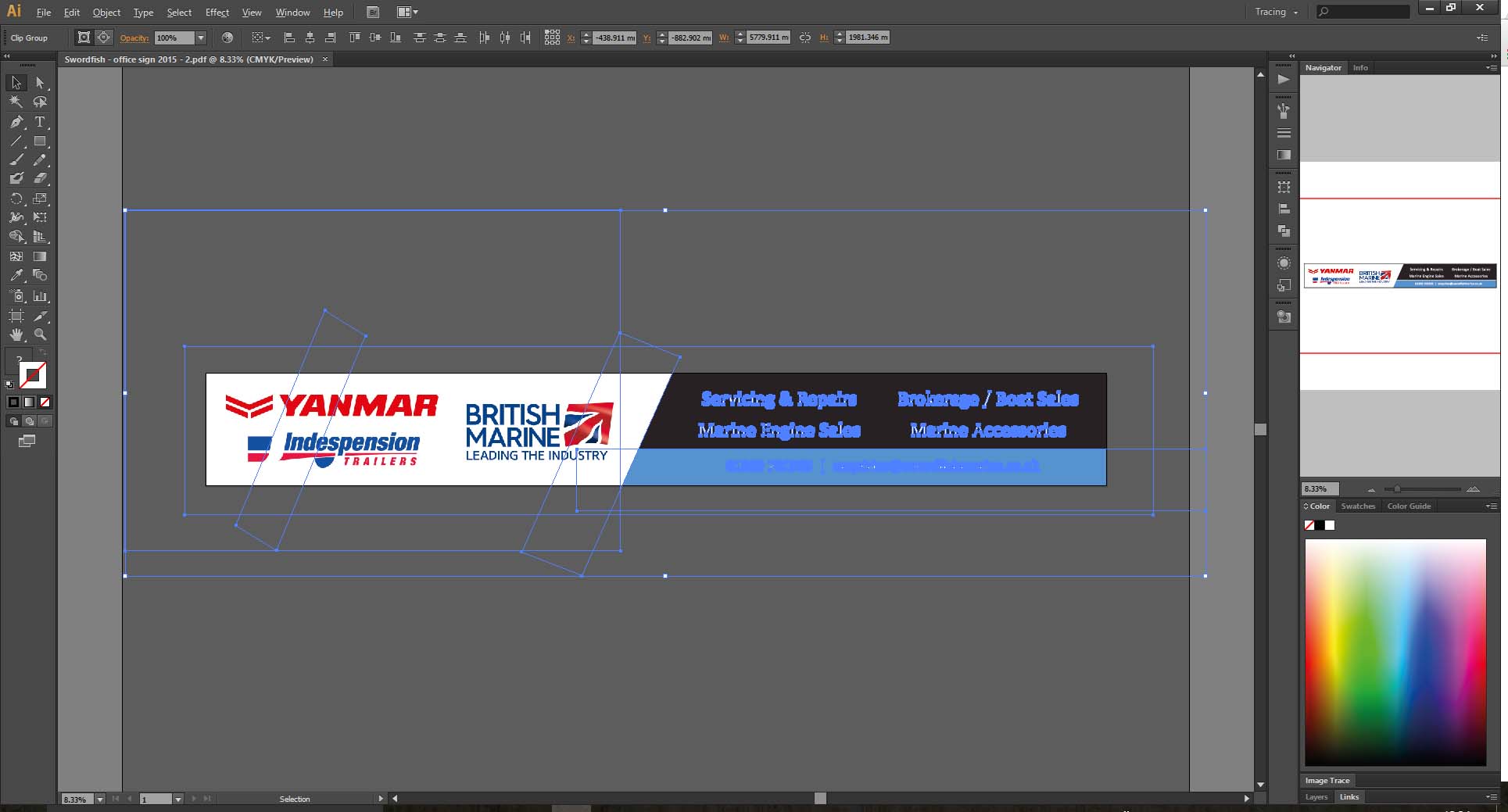

    I’ve had these two designs sent to me by a web designer, When i open in adobe reader they are fine but i need to resize them.
    This is the bit i’m going to sound thick with.
    When i open with AI or Flexi they are opening as separate layers (i think) and i don’t know how to chop off all the ‘waste’ to allow me edit it the way i want. Ive attached the 2 files. Its probably really easy if you know what your doing. Hoping someone can help as i need to get these away to print today.

    Thats really weird. But thanks. This is how they open on my AI. Can i send you the other one, see if its the same?

    That is because the various components of the image are clipped.
    If you create a clear rectangle on the top/front or new layer to the size of the actual image area, over the whole image, then select everything and right click & ‘make clipping mask’ it will leave you with a clipped single image that you can rescale as needed.

  • Ewan Chrystal
    7 September 2015 at 12:49
    Fantastic cheers, love learning new tips

  • Ewan Chrystal
    7 September 2015 at 13:08
    Done, dead easy when you know how lol

  • Kevin Flowers
    7 September 2015 at 23:12
    In Flexi create correct size rectangle to front select all and Mask anything outside of the rectangle will be hidden

  • Ewan Chrystal
    8 September 2015 at 07:47
    Of course Kevin… That one never occurred to me
  • Jon Marshall
    8 September 2015 at 09:04
    Most files from designers are like that. Can be a nightmare getting a full wrap artwork into something printable.
