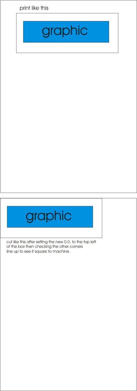

  • Chris Wool
    21 June 2007 at 15:11
    no the origin only re sets the 0.0. position to where the blade is when you press the button .
    print 2 cross hairs the top left one is then set to 0.0. the other one is check only that you have the print in square.
    set the cutpath on your page to match the new 0.0.
    clear as mud.
    chris

  • Chris Wool
    21 June 2007 at 15:26
    might explain
  • Chris Wool
    21 June 2007 at 15:30
    quote :
    I assume that the optical one is just the lazy mans version of it.
    no on the rolands and graphtecs etc. it takes in to account any skue and distance traveled and adjusts the plot accordingly thats why it can not be added unless the machine knows about it.
    chris
