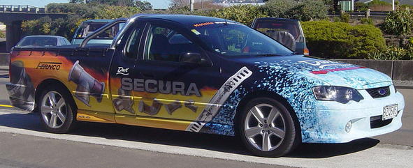

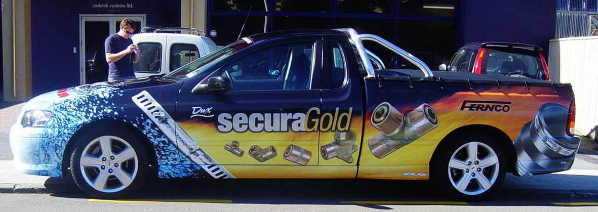

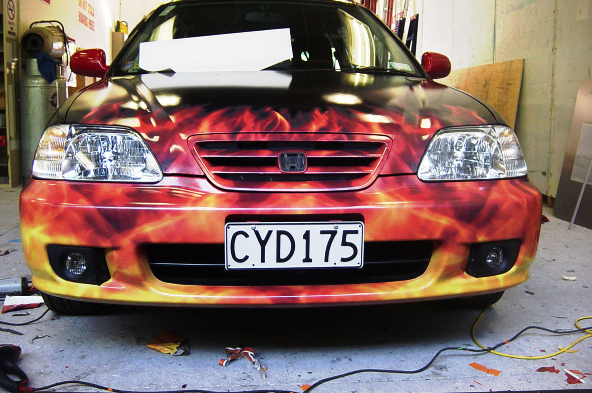

Some of my work 🙂

I love your wraps. I was in NZ last October and was amazed at the amount of wraps I saw. I think you guys are far ahead of us here in Oz for that sort of thing, on a per capita basis. You must have a good price for your material.
What material do you wrap in? I hear Mactac is big in NZ.. I have been using Oracal 3951 but I’ve recently changed over to Avery EZY apply.
