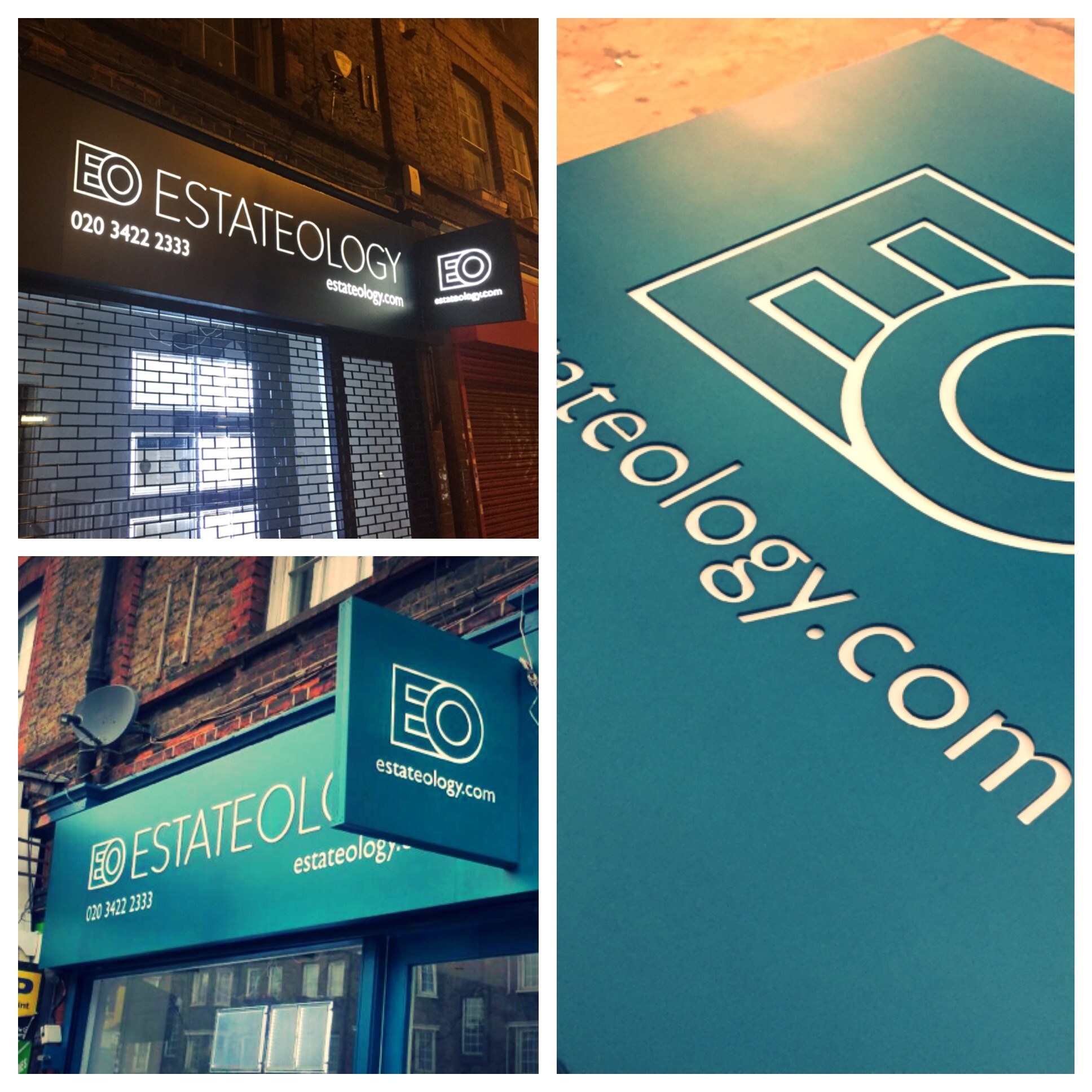

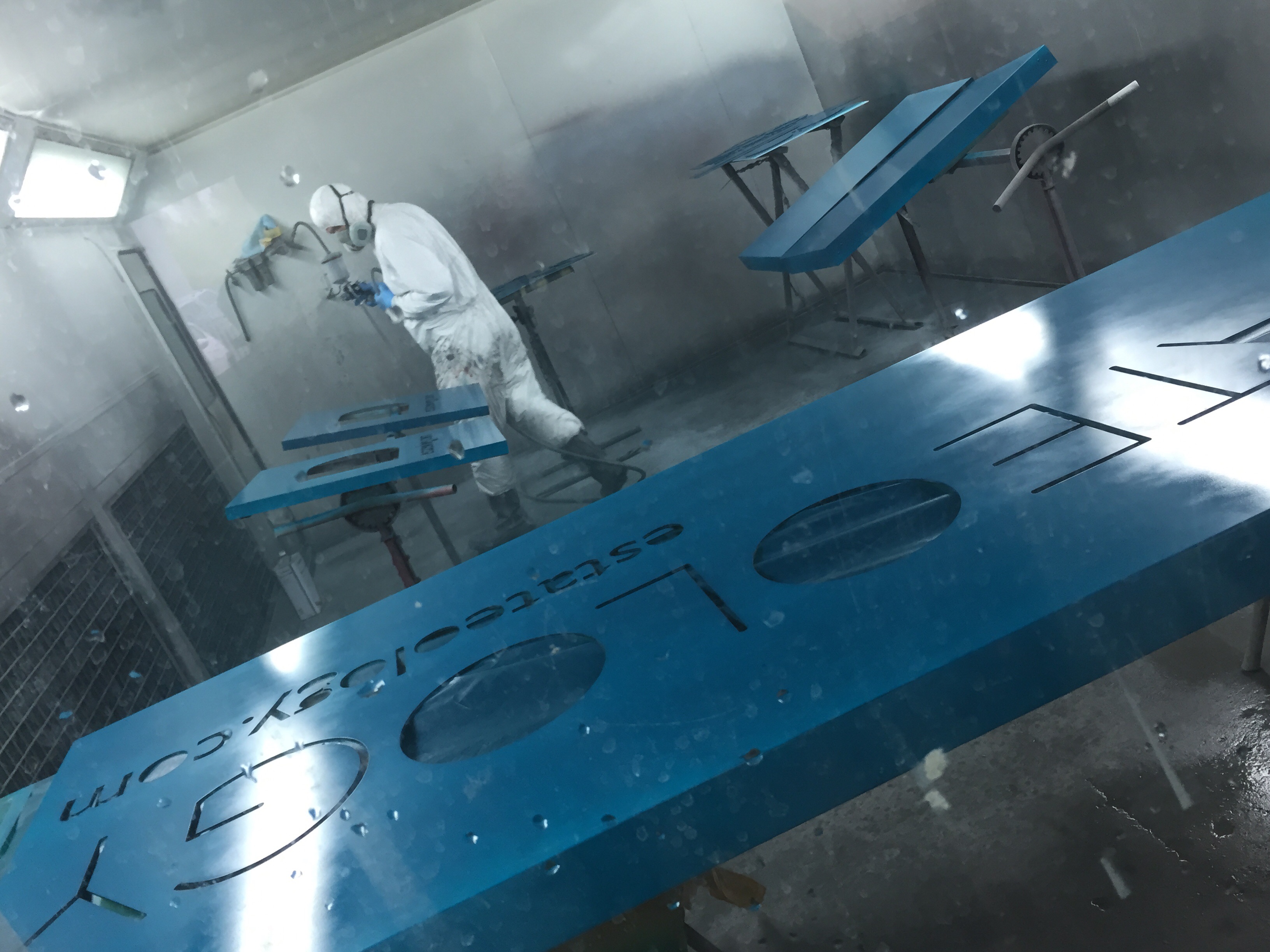

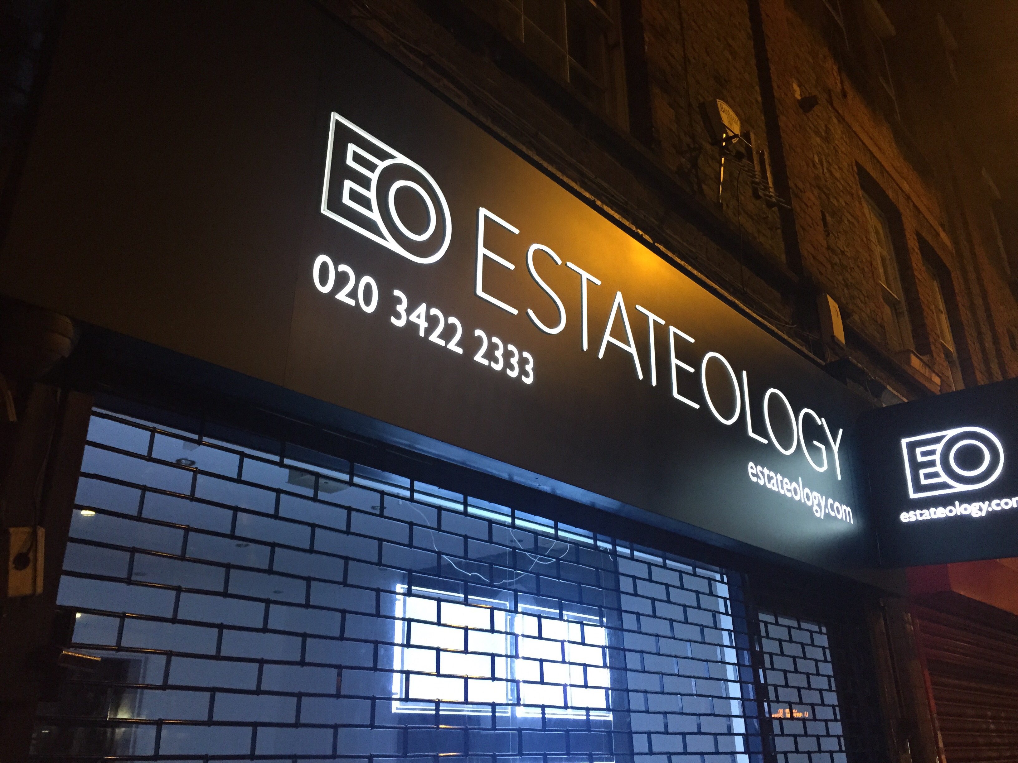

    We recently had a tricky colour to match and we wet sprayed it
    Tray made using blackburns metal 0.3 skin sheets in white…flattened down with sander…
    Be bought a RAL colour and some Matt lacquer. Made sure if yiur sign had multiple panels side by side you lay these all together and these are painted in one hit to ensure colour match
    Have a look at the images attached
