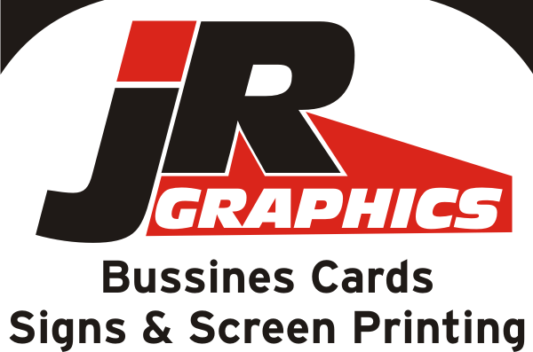

  • joseramos
    21 March 2008 at 06:50
    Thank you Simon, to be honest I’m still learnig the design principles.
    Can you and the rest post some designs for me please.
    Any sample will be better than mine
    Thank you all!
    Please see attachment of my logos

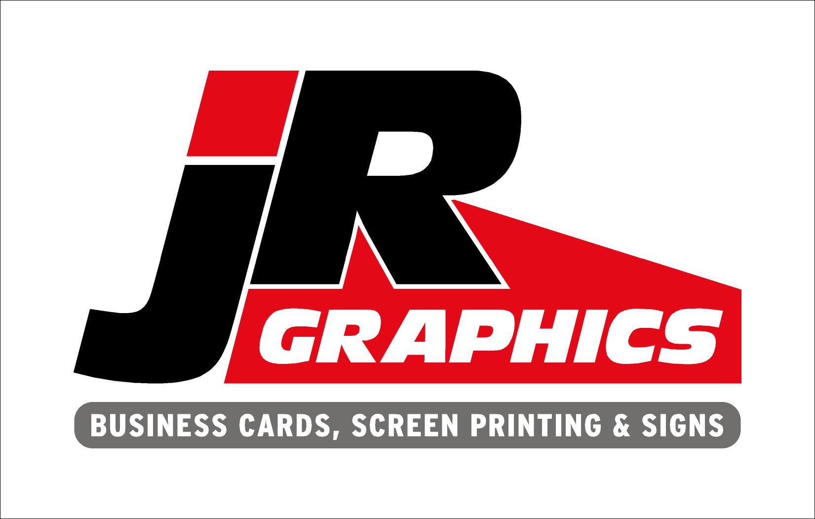

  • Simon Strom
    21 March 2008 at 14:00
    Ok I’ve done a few things here. I straightened the line on the bottom of the red shape that the word "GRAPHICS" is in. Also the angle on the left side of that shape I thought should match up with the angle on the left side of the "R". I also evened out the drop-out rule line around the "R". I used Interstate Black Condensed for the tag line. I tried getting the copy to work on the bottom a few different ways, but the breaks in the line are a little awkward because you have two long phrases and one short one. If anybody else has any ideas now that would be cool to see.
  • joseramos
    21 March 2008 at 22:03
    Thank you Simon now the logo is taking shape.
    It is amazing how some little correction can change the look.

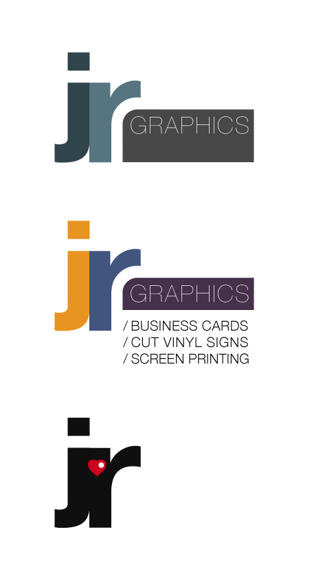

  • Andrew Boyle
    21 March 2008 at 23:08
    I think the other colours in the attached file work better….I don’t like red and black together…I think of 80’s shoulder padded jackets, Michael Jackson, matching duvets, borders and a cheeky wee bedside lamp 😀
    I would work on the other ones.
    I agree totally with Simon but think it might be nice to look at the cooler colours 😀 😀
    think JR was shot just below the heart though 😀
  • joseramos
    22 March 2008 at 14:31
    Lynn, I’ll use the logo for business cards and also for a cut vinyl sign on a vehicle.
    Andrew’s design looks great but I prefer JR instead of jr since people think it stands for junior.
    Thank you all for your imputs.

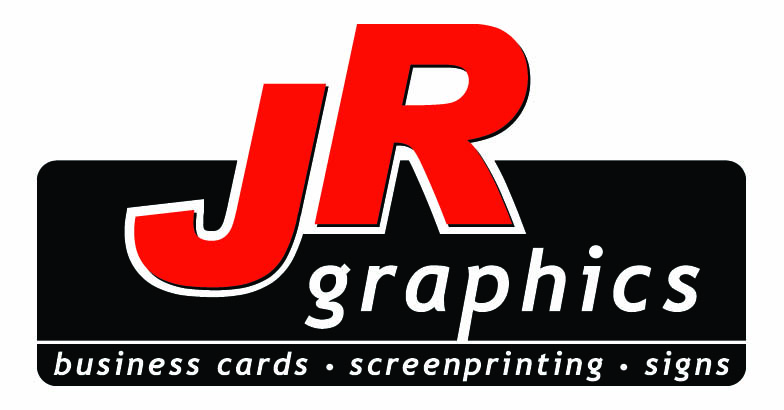

  • Hawaiian Sign Dude
    8 April 2008 at 08:08
    I was just hanging out drinking a beer and looking for a project so I whipped this up.

  • joseramos
    9 April 2008 at 00:04
    Thank you Hawaiian Dude, that design is very neat. I like it.
    Can you tell me which font you used for the letters.
    9 April 2008 at 08:36
    I’m glad you like it. The fonts are: Arial Bold Italic (JR) and Trebuchet MS Bold Italic. I am attaching an EPS file if you want to use it. If you want to cut it in vinyl all you have to do is weld the red JR with the black JR drop shadow and plot everything with Black vinyl. Then cut the red JR with red vinyl and drop it on top.
    9 April 2008 at 08:46
    After I post something and read it I always realize I left something out! I mentioned cutting everything in black, but that would be if you were applying it to a white surface and then you would reverse weed the white copy out of the black. If you were applying it to a different color surface then the white copy would have to be cut from white vinyl (if you want it to be white) separate from the black. I’m sure you know all this but I still wanted to mention it.
