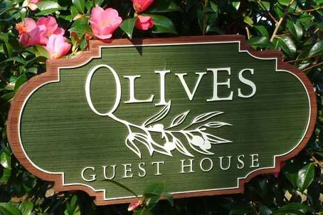

    Depend on if you want to sub this out or not, as these signs can be very very expensive.
    Ideally made from Canadian cedar I think.
    The firm who does my routing work is one of the leading suppliers of this kind of sign in Europe, they are all sandblasted & made to a exceptionally high standard.
    Im not sure about the faded effect, I would assume they would feather it out using varying degrees of lighter paint bus whatever, they would be able to do it.

    Is this the kind of thing you mean

    Yes that’s what I mean but will have to find out about the fade effect.

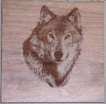

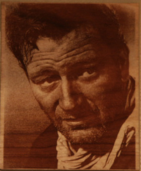

    I’ve been looking around the boards and found this link with laser engraved signs (the wolf and face signs in particular)
    http://www.uksignboards.com/viewtopic.p … ght=wooden
    I was wondering if this would be suitable for the redwood logo I posted for exterior use?
    Anybody know about this or can make any suggestions?

    Warren, I think you might be better off with an HDU sign rather than the redwood.
    Unlike wood, it has no grain. Therefore you could get the raised up letters by sandblasting and just airbrush the fade into the background like the first pic you posted.
    HDU blasts like butter, is easy to work with, and lasts a very long time. It’s pricey, but then again, so is redwood.
    Another option would be to have it routered as a bitmap texture, not sure how this is done, but have seen signs done in this fashion.

    Have a look at these guys Warren, http://www.thegrain.co.uk/ nice sandblasted signs.
    I had a go once, with success. But sandblasting is a horrible job. You can buy the redwood yourself and cut the mask, then get someone to blast it for you though.
