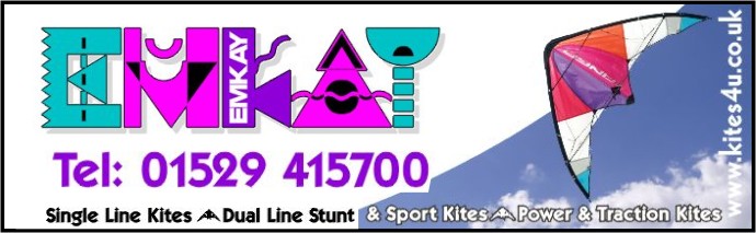

    Right before we start NO I didn’t pick that font the owner did and he’s "been using it on my website and stationary for years" so don’t blame me, gonna be dibond and digi print though I did mention using a real kite, any glaring awful mistakes?

    1 July 2004 at 20:22
    I like it Steve… looks very different… even if the fonts a bit nutty… πŸ˜‰
    I like the sky being cut away like that with the kite poking out of it… very smart.
    constructive critisism:
    Take the phone number and make 2/3 the size
    The bottom line of text (black) I think would be better closer to the (white)
    Letting the (&) cut through the blue sky into the white. The kites between the words ide maybe make simple vertical lines slightly larger than text and in the pink above.
    I just feel the kites in between makes the text flow into each other, making it a little harder to read from a distance…
    The main word I would drop the height slightly too… I think the left hand side of the sign needs some more white to breath… looks a little tight-knit.
    Great work as ever though mate… Thanks for taking the time to post. πŸ˜‰

    1 July 2004 at 23:01
    Hi
    I’d align the lettering on the left to a vertical line, make the black lettering flow into the outlined black without a gap, align telephone number to possibly the end of the word ‘stunt’, make margins top and bottom, left and right the same and outline the web URL in black as it gets lost in the clouds, just some thoughts Steve πŸ˜‰

    2 July 2004 at 08:20
    As mentioned the gap between ‘stunt’ and ‘&’ needs addressing, perhaps a rounded
    corner box for that line of info so that it pops out.
    Also as mentioned the web address is lost as it is. I’d suggest as this will be a digi print
    to give it a drop shadow effect it photoshop, just enough to make it pop but not so much
    that it competes with the other elements in your layout.
    Hope this complements the other feedback you’ve had.
    Cheers Pete

  • Steve Thurlow
    2 July 2004 at 08:44
    Yo Steve, How’s it hanging 😎
    Looks great…… but, (HA…. payback time πŸ˜‰ )
    How about making the sky a brighter blue? looks a bit dull, maybe a typical Brit Summer’s day. πŸ˜•
    Also a subtle drop shad on the web address,
    Apart from that it’s lovely mate πŸ˜†
    Cheers, Steve
  • Steve Thurlow
    2 July 2004 at 08:49
    ……. Also, at the rear of the kite image, should you have cut out the white background between the kite & ‘string’ to show the sky?
    Steve

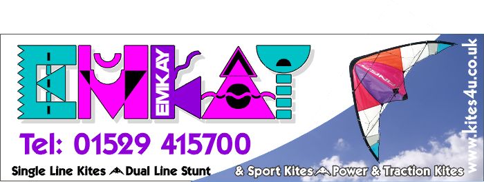

  • Simon Clayton
    2 July 2004 at 09:09
    Hope you don’t mind, i had a bit of a play, bit difficult working on a jpeg

  • J. Hulme
    2 July 2004 at 22:28
    Cool, but doesn’t flow as well as the original, everything is still unaligned and the impact of www is not solved, the sweep of the sky and kite on the original is perfect, just wants aligning and outlining properly, the chosen font (customer choice, not Steves) is horrendous, if the customer doesn’t want anyone to actually know his business name then he’s a fool, modern, but a fool πŸ˜‰

  • Simon Clayton
    3 July 2004 at 00:20
    It hard working with just a jpeg as it has to be crop and stuff…
    If an ai file was posted it would be far easier to change text and layout.
    There needs to be more balance, more space around the text move the web address in from the edge.
    I can’t see a way of the text crossing the sky without the sky being cropped, or just have it as two separate sections of text.
    The web address needs to be a different colour, possibly render the sky onto the text but reverse it so that the dark part of the sky ends up on the light part of the sky, (if that makes sense).
