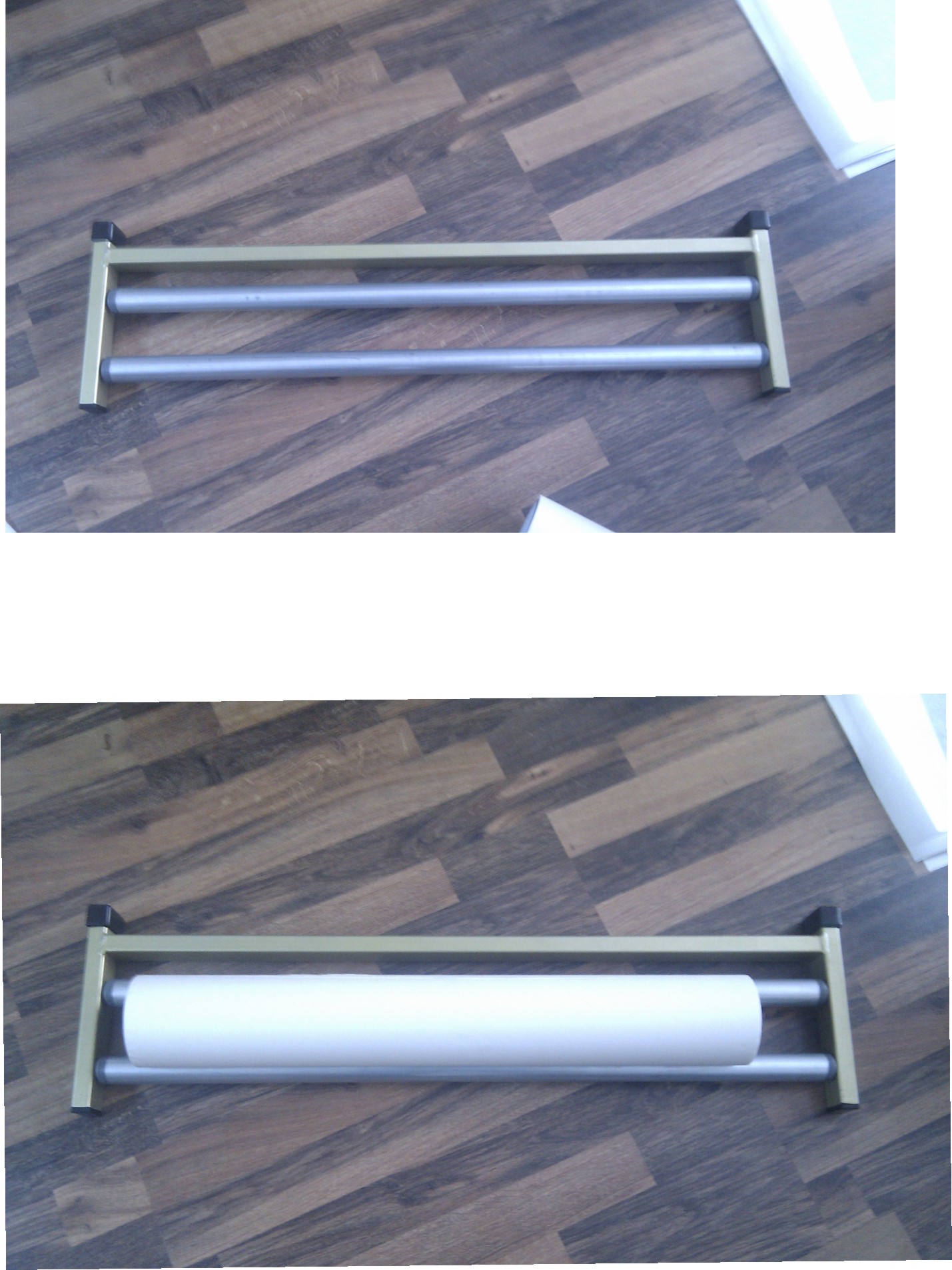

    Hello Folks, Bought this piece of (ooops) from Doro, thinking it would aid me with my application tapes. I work from home and the biggest space I have is my sitting room floor, so this I thought would be great
    Problem with this is the application tape is too sticky (even low tack), so when you pull it well it comes off the rollers, have any of you got one and modified it in anyway.
    The only thing I was going to do is put a couple of heavy suckers onto the feet, to stop me pulling it across the floor, but I have not done that yet, due to the rolls coming of the (oops) thing

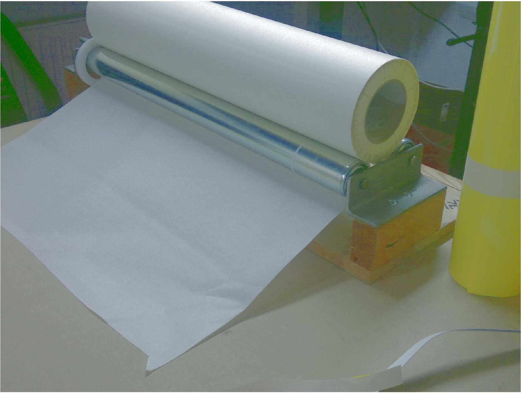

    don’t know how you are feeding it but i run my self made one under the front roller this means it is being pulled into the rollers so cannot jump off.
    Mine does sit higher this allows you to attach the tape to the work bench forming a tent & then use your hand to apply the tape to the vinyl

    Kevin, something so simple as feeding it under 😳 has worked a treat, now I just have to stick it onto a non slip mat, or stick suckers on it,,,,good call mate

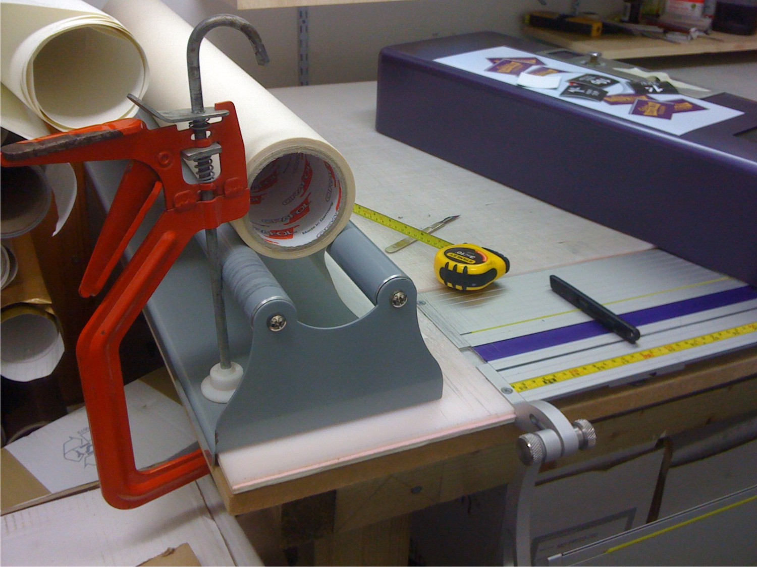

    Personally I don’t use a dispenser like this but mine does the same sort of job. I have a delux application tape dispenser & graphic installation workstation which is really handy as everything is kept together & can easily be found.

    yes mate conveyor rollers mounted to stainless steel angle, the wooden base as a ledge so that it grips the work bench. I have taped up to 5 mtrs but normally i will do half & then spin it around.
    Made this back in 2001 & used every day

    Thanks for all the replies The only thing here is I do not have a work table I use the floor, as I work from home pain in the neck, but I get by,,,,,,,

    Couple of hooks in the skirting board and a bit of nylon string or if that’s not possible tie it to something like Robert suggested might be an idea. Looks a bit light which is why I’m not convinced a non slip mat would work. Or find something with a bit more weight to attach permanently or just rest on top to try and stop it moving. As you are working off the floor you don’t really need a lot of extra height as you will be pulling the tape off the roll in an upward direction I would have thought.
