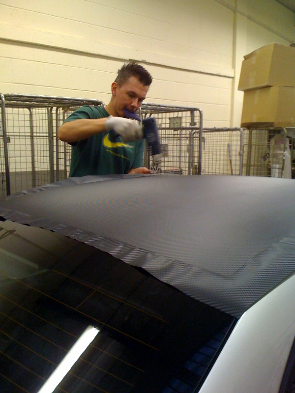

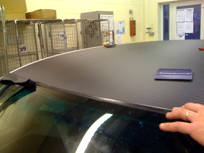

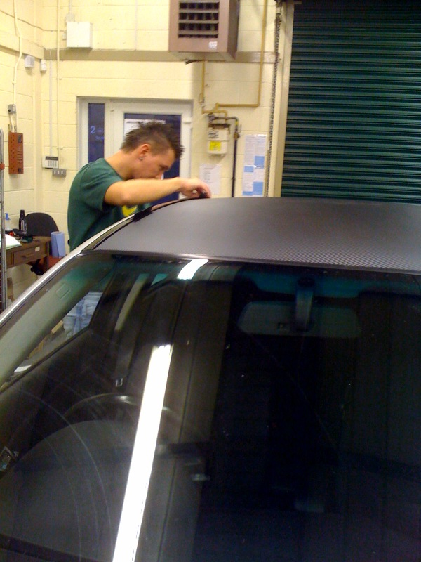

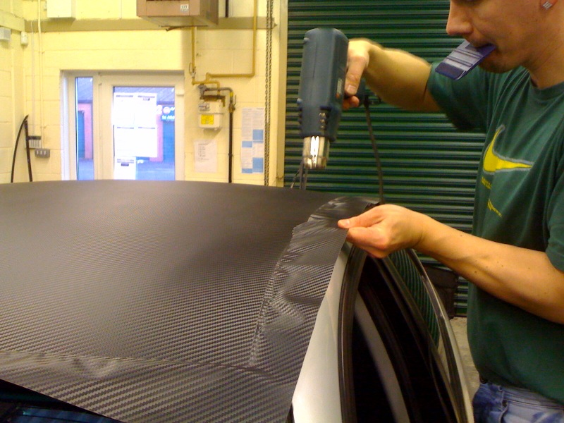

    5 December 2009 at 22:08
    Hello.
    I do apologise but I couldn’t make it this weekend (vinyl hasn’t arrived on time – it’s my fault – I could order earlier)
    Anyway I’ve managed to do roof in Carbon Fiber (3M – CA421) it looks fantastic and I’ve found quite easy to apply.
    Some pictures:

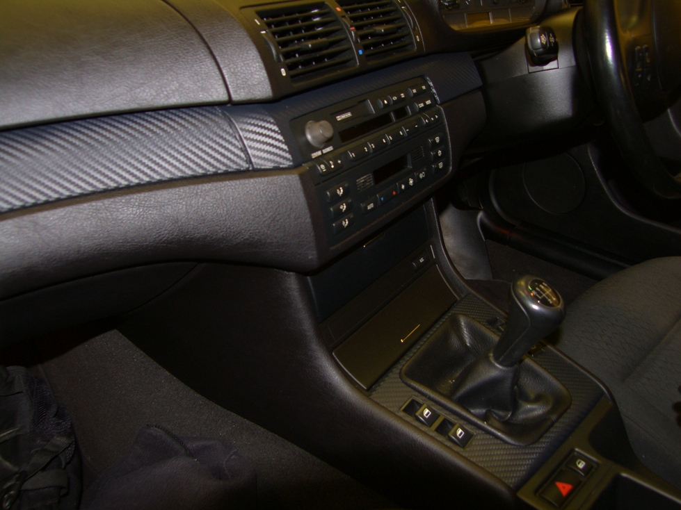

    Peter, you were right about door handle – it works fine. I’ve got another question: How to remove the plastic panel around gearstick? I’ve found two plastic snapfix on the top but bottom is still well fixed and I can’t puul it out. I don’t wanna break something.

    Peter, I did it – I mean the gearstick panel.
    Nobody comment about my pictures so i presume everybody don#t like it 🙁

  • Andy Payne
    15 December 2009 at 23:13
    Ithink the reason for the lack of comments is that we cant actually see the finished roof pic, looking forward to seeing the finished result. Quite keen on this subject as \Im thinking of wrapping my beemer with Carbon – yours is looking good so far mate 🙂

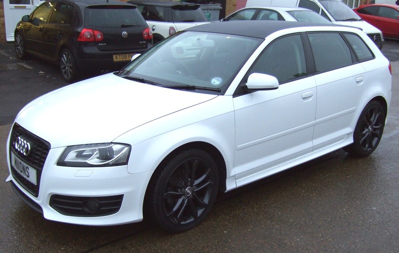

  • Jon Marshall
    16 December 2009 at 09:38

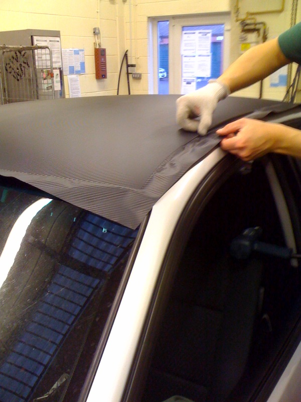

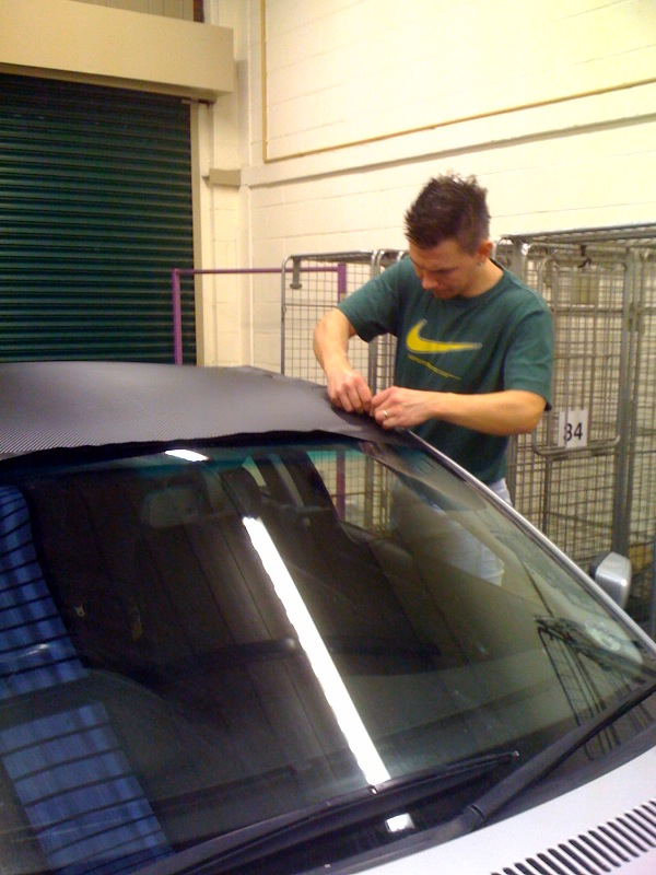

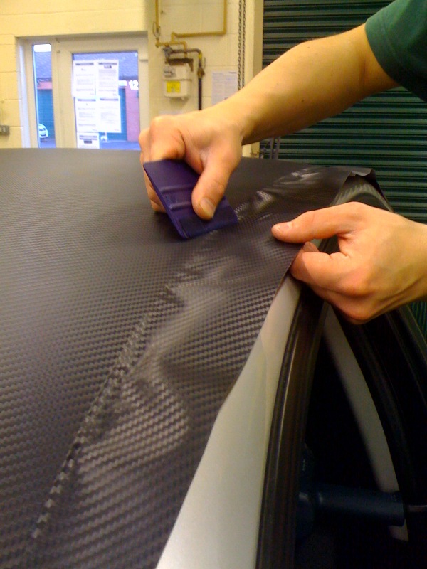

    We did an Audi yesterday with gloss white and 3M carbon roof. The 3M one feels really thick and plasticky but goes on well with a bit of heat and the weave doesn’t shift a lot like the APA one.

  • Jon Marshall
    17 December 2009 at 09:45
    Here’s a pic of the finished job;
  • Michael Szwacki
    17 December 2009 at 17:19
    Nice one Jon.
    What vinyl have you used?
    How long did that took you?
    Are the plastic trims on the doors wrapped? Did you took them off?

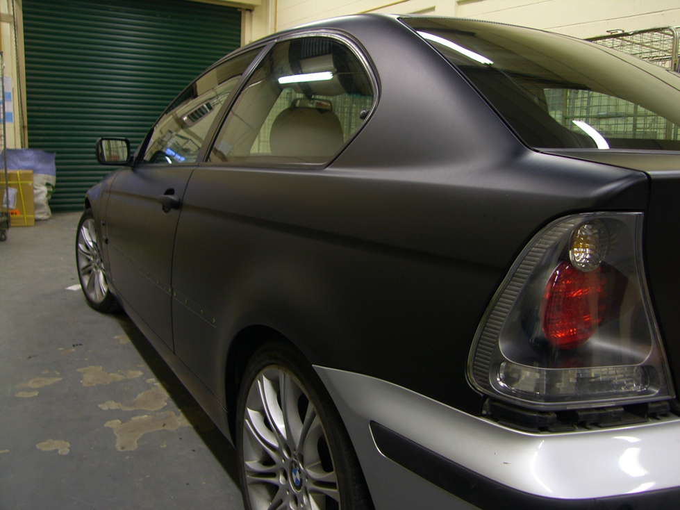

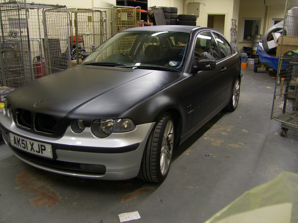

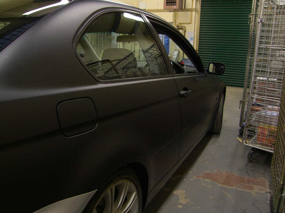

    31 December 2009 at 14:00
    AAAAAAAAAAAAAAAAHHHHHHHH !!!!
    I’m short of vinyl !!! 🙂
    Not enough for bumpers and I have to wait till next week, booooo 🙁
    Anyway – progress so far:

    31 December 2009 at 17:20
    Can you wrap bumpers with vinyl ?? I thought they were made of the same low energy plastic that the bump strips are made from and I know people have said not to try and wrap those.
    Oh by the way, Looking good so far Michael, how did you run out of vinyl ?? Was it simply a case of not ordering enough to start with or have you made a few mistakes along the way ??
    Have you sorted the problem with the glossy look on tight compound curves.

    31 December 2009 at 17:45
    Martin.
    Bumpers are sprayed so they should be fine (i’ve done lot of them and never failed).
    Running out of vinyl – yes I haven’t ordered enough. My mistake because I didn’t count how much I’ll need. Friend of mine done vw passat – 4 doors one and he used 13m, my car is smaller, 2 doors and roof is done in carbon stuff so I just tough 10m will be enough. 🙁
    The gloos marks still there – mostly on bonnet that’s why when I’ll order more vinyl I’ll do bonnet again. But Jason advice about less heat also works fine and now I’m doing well.

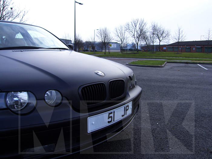

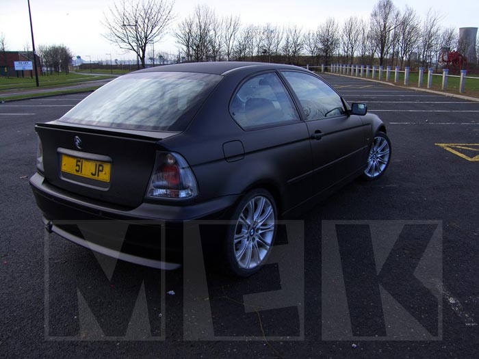

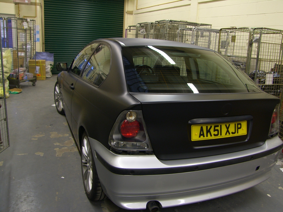

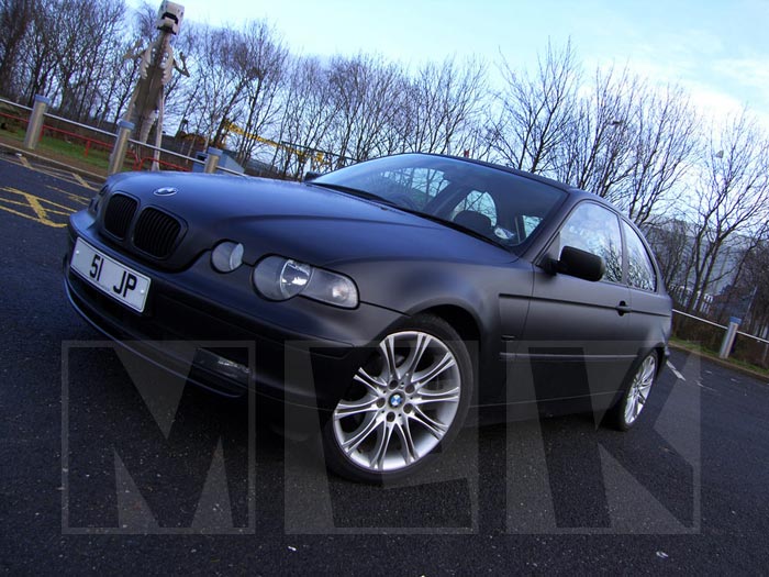

    17 January 2010 at 18:31
    Hello again.
    Finally i’ve finished my car. I had so much troubles with bumpers and spent on them a lot of time but finally they are done.
    17 January 2010 at 18:53
    looks good Michael, what trouble did you have with the bumpers ?

    Looks to me like you have done a very good job there Michael. How many meters of material did you use in total?

  • Michael Szwacki
    17 January 2010 at 23:01
    Bob – I’ve used around 13m black matte + 1.5 carbon fibre on the roof.
    Lynn – It’s just so much shapes on them, a lot of stretching and you have to really be careful with this vinyl – to much stretch and heat and you have gloss marks. I think i would spend half time if I would take them off. Also on the front one i couldn’t take the headlamps off (in this model you have to take the bumper off before :()
    17 January 2010 at 23:14
    Looks very good Michael,
    well done,
    now you have done your own as an example, what do you rekon you could charge to do a customers car, and would you be able to make a decent profit?

    18 January 2010 at 10:57
    quote Michael Szwacki:
    Nice one Jon.
    Hi Michael
    The Audi was wrapped with Avery 1900, it took 1 day with 2 fitters. Plastic door trim was colour coded already so just wrapped over.
    Well done on your wrap. Looks good.
