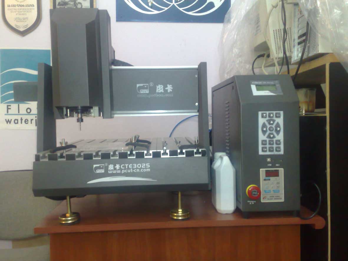

    Hi,
    I have purchased 2 new pcut CNC machines model CTE3025 (cnc router) but could not send any job to the machine. I could not install the USB driver from the CD that was in package and the machine can not read any nc file directly form the SD card.
    I didi everithing refer to the instructions, however no result.
    Can you advice how to fix the prolem and engrave>
    Bekarion

    The machine I have got has the controller installed on the main controller box.
    the software I got with the machine needs the password that was not provided and impossible to contact Creation head office because of Chinese new year holidays till February 16th, however as explained in the users guide it is not necessary to have the software and the nc file can be read form SD card, however machine still cannot execute any information from the SD card.
    At the moment what I need, is the way how to avoid passwords and how to unblock the machine? Do you think it is possible?
    I need to make the engraving of very urgent design for the customer who can not wait till 16th.
