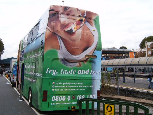

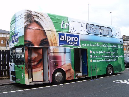

course i did…with 3 other employees in a barn in oxford.
start at the top right and work ur way around like hanging wallpaper..
vws dry application with a little heat needed to tease some of the curves.

vws is an incredible product considering how thick it actually is.. very unlike a cast comformable vinyl..

only printer i have is a gerber edge…
and no i didnt do the bus with it LOL..
that was done on a vutek..

the bus was in a barn being fitted out so there where no dolly birds there handing out free samples, just a few chickens.
after that the bus went to london and was only used for 2 weeks then stripped.
