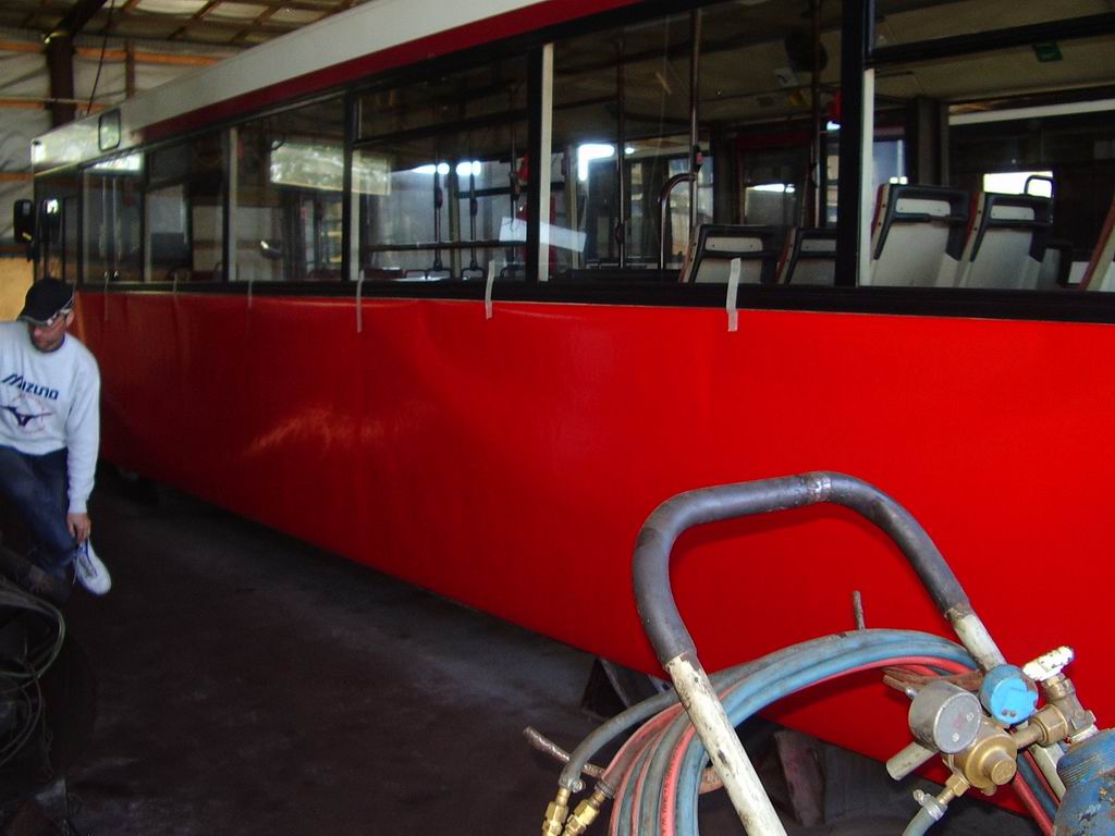

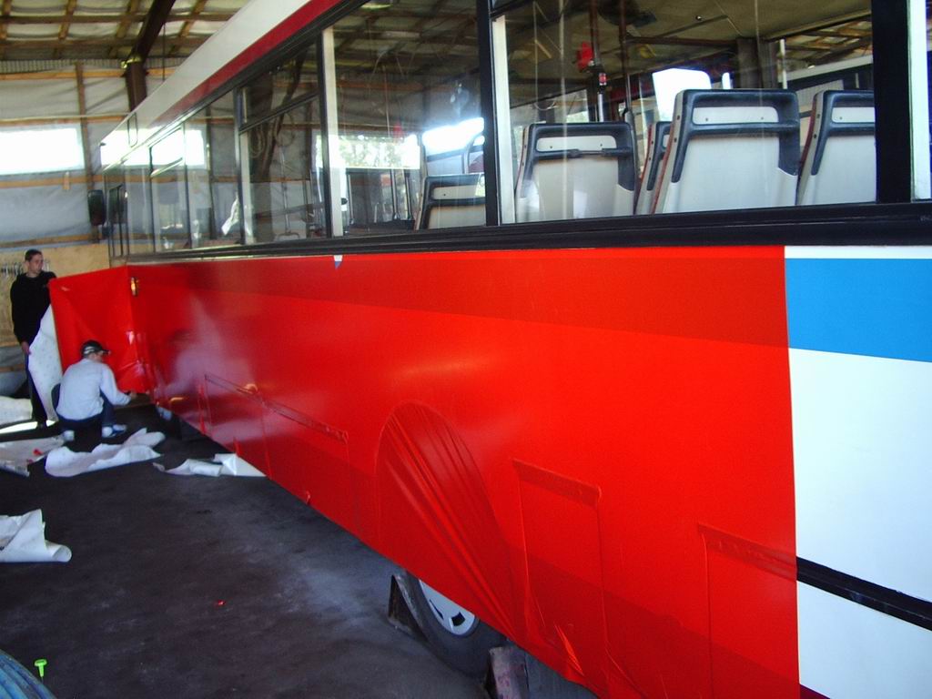

    great stuff mate… big job and a time killer.. 😕 its bad enough doing this type of application but add the trimming/cutting around petrol caps, doors, flaps, moulding etc etc turns it into a bit of a nightmare.
    what vinyl did you use and did you apply wet or dry?
    thanks for taking the time to post your work mate. 😀
  • Mindaugas
    4 June 2006 at 20:57
    yes, one side take 8-9h and next side 2h, i apply dry way because in wet way its takes longer time and i think when use wet way is to complicate apply
    small pieces.
    i use AVERY vinyl and for digital print KPMF, for windows VISION ONE,
    4 June 2006 at 22:01
    thanks for the feedback mate…
    im with you on wet app "isnt" the way to go with this sort of thing. in my view its definately the inferior way to apply on this sort of vehicle. i can only see it taking longer to fit, and its a long enough fitting as it is.
    all too often do i see wraps applied wet to buses, tell tale signs of sagging or toren vinyl around mouldings and the like are common.
