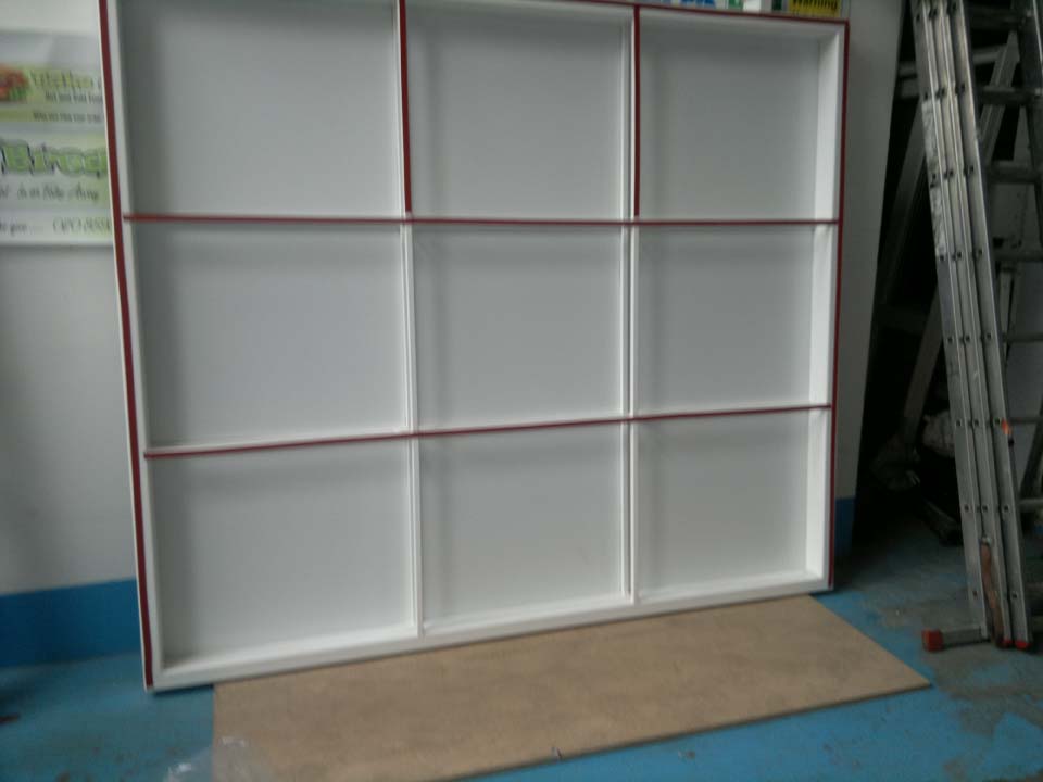

    PIC 1
    A steel frame was constructed from 100mm x 50mm box, this was then cross linked with 25mm box to give support to the panels. Feet where added (although at the top of the frame in the picture) These mate up to 100mm x 50mm x 700mm foundation legs that I have concreted into the ground. The frame was then powder coated in zinc primer & white topcoat
    The panels are secured solely with VHB tape

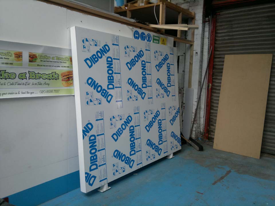

    PIC 2
    The frame with both panels on & now standing on its feet these will eventually be bolted to the foundation below ground level. The edges will be capped with 1mm aluminium plate. ( Although pictures of this have been mislaid)

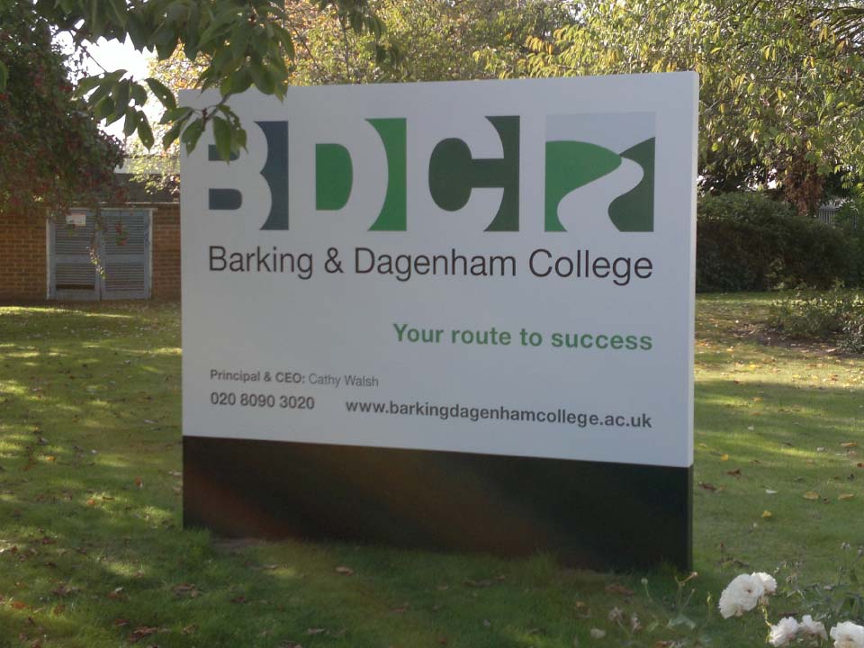

    PIC 3
    Edges capped and the complete sign spray finished .

    How did you hide the joins in the dibond ?
    23 October 2011 at 10:50
    Brilliant work Kevin – well done. Did you fabricate the frame yourself or was this done by a specialist? I also wondered how you had hidden the joins and how you dealt with the edges?

    Yea, smart! The only thing that made me think was that although the VHB tape should be perfectly up to the job, it will only be as good as the adhesion of the powder coating to the frame. I have no experience of powder coating so I’m only flagging it just in case. I’ve seen problems in the past where VHB tape was used on painted surfaces and the paint was the week link. Just a thought.

    Frame was designed by myself & fabricated by Heritage Steel (Next Unit to my own) who i do a lot of work with. They also have powder coating in house so the frame was cleaned – heated – primed then top coated so no problems with adhesion. I then clad with the dibond sheet using VHB tape, 3mtr by 2mtr sheets where used so no joins. The sheet was cut edge to edge of the frame, then the ends where capped with 1mm aluminum stuck in place with BOSTIK SIMSON ISR 70-08 & appropriate primer. This gave a very good corner finish although i did run a file down the edge on one side.
    The assembly was then sanded & etch primed, it was then finished with 3 coats of satin signal white with the base being masked & finished in satin black. All wet spraying was done by myself and due to being satin finish needed to look good straight out of the gun no polishing.

    Yes, a seriously well constructed job – and looks the part too. A 3M x 2M sheet of VHB is much more than I had expected. I’d thought it might have been a series of strips. Hope you didn’t think I was casting doubts on your work Kevin – it’s just that I’ve fallen foul of painted surfaces in the past and it just leapt out at me.

    the Ali Comp is 3×2 the but there is 12 linear meters of VHB on each side. Posted it for discussion and you may have had a valid point so no problems, sharing experiences good or bad is what the boards are all about.
