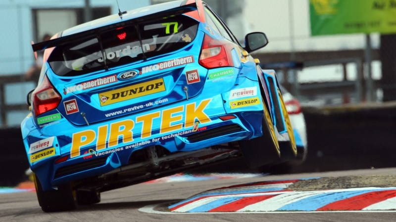

    Hi all
    few pics of the #7 BTCC car we printed fully and wrapped for one of the teams we (babysit) take care of.
    And the sister car of chrome doom!!!
    carry on. . .

    Do you racing car specialists wrap with the lettering printed on the wrap? or do you apply it afterwards?

    As for the logos and lettering, we tend to print and contour cut them, as sponsors etc can change race to race, and if there is a bit of damage we can swap out logos as opposed to a re wrap of the entire panel

    What Blue Chrome wrap did you use and how did you find working with it?

    We used Hexis for the chrome and to be fair it was absolutely fine to work with, not quite as supple as the Avery version but if you get enough heat into it it will go quite far. The only downside is it does bruise quite easily, so have to be a bit careful.
