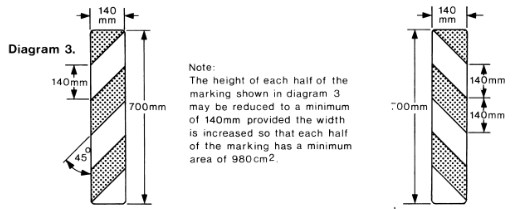

    Ive been asked to price up some magnetic chevrons plates for containers with markings to this standard.
    british standard BS AU 152:1970 (The film must be marked with this number)
    Anyone know which film I should be using?
    Jim
