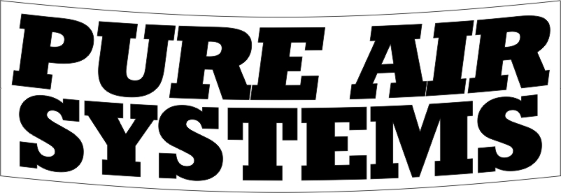

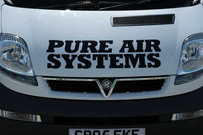

    here so i can add pics
    this is how i do them
    lay a straight edge across the bonnet to see the amount of curve and apply that via envelope in corel.
    chris

    on the screen it looks like this

    That’s a really good idea!! I might start taking a less random approach to combatting ‘sad text’ from now on.

    you could take it a stage further by doing it this way you can have a different radius top and btm so for bigger graphics on the bonnit or rear windows you can follow the lines of the vehicle. and distorting the weeding box with the graphic makes it easyer to fitt.
    chris
