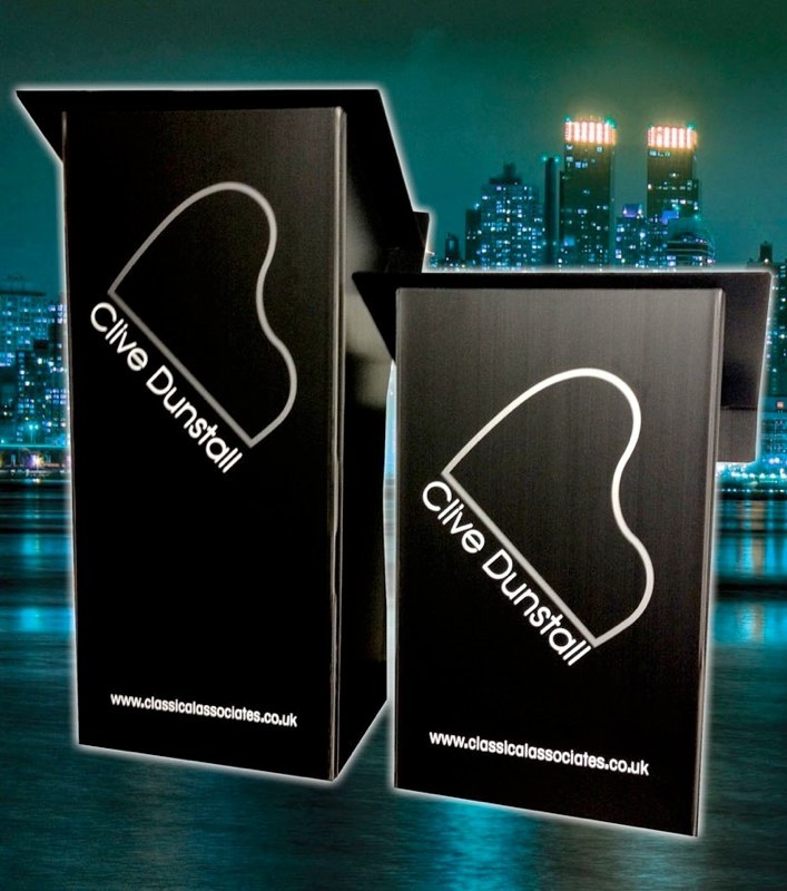

  • Billy Lawton
    3 December 2012 at 22:59
    By the way – these are the stands I make – mostly cut vinyl fronts – or I send out for colour digital vinyl prints that I mount myself.
    The welding I need a better solution for is on the tops – you can’t see it very well in the image here – but it’s the top bit that bends back to hold the music.
