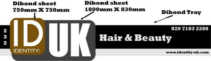

    I will have a Dibond tray and I will be bonding another piece of Dibond 1800mm X 830mm directly on to the face of the tray. I will then be bonding another piece of Dibond 750mm X 750mm on top of the other piece of Dibond. It will make a 3 layer sandwich of Dibond.
    Will VHB tape be all I need to bond these 2 pieces on top of each other on to the Dibond tray? and how much tape should I use?
    Warren

    As you can see from the design it would be hard to hide the screws so that they did not show, I’m sure VHB tape will be enough( and I’ll use lots of it)
