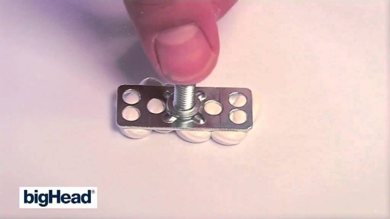

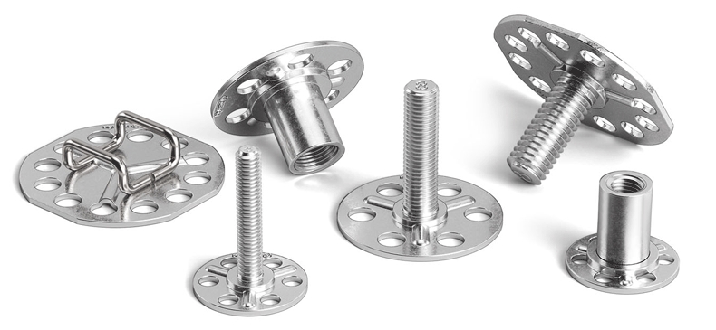

    A threaded rod with a nut on the thread is fed through the hole in the composite, and a second nut tightened onto the rear of the thread.
    Obviously your “not” talking about a metal letter. so, if the threaded rod is then attaching to the letter, you could use a Big-Head fixing?
    Basically, the base of the bighead is a perforated metal plate.
    You squired a strong adhesive blob on the letter. press the big head into the liquid and the adhesive squirts through the holes.
    you leave it to solidify and you now have an anchor point for the threaded rod.
    Bigheads come in loads of shapes and sizes, with different fixing types.
    so you can buy ready-made bigheads complete with threaded rods.
    Or you can buy JUST the bighead plates with a small nut fastened to them. this means you can screen in your own rods at different lengths if you wish.

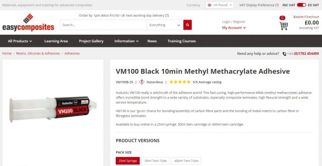

    What adhesive would you use?
    guessing not Tensol 70, maybe a no-nails type of thick silicone I’m guessing?
