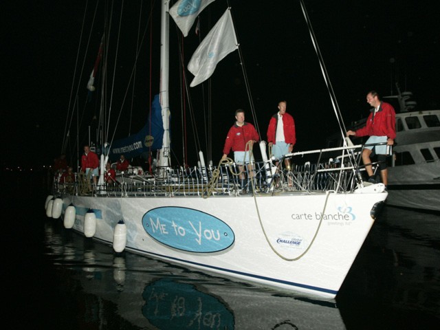

    This is a project to signwrite 12 x 72ft identical yachts for a round the world race last year – this is just one of them – ill post more pic soon – idea of size of oval 10ft x 5ft

    26 August 2006 at 20:35
    Soory Mole Did you do the graphics? or are you just looking at Ideas?
    26 August 2006 at 20:36
    hi when you say signwrite do you mean you painted it? 😀

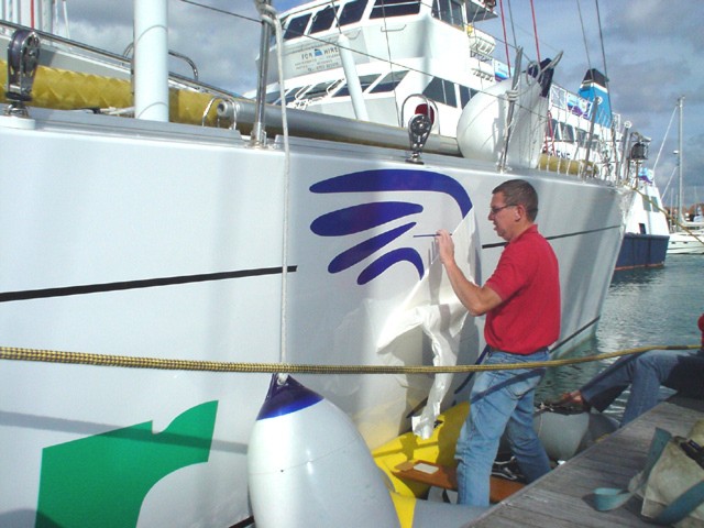

    26 August 2006 at 20:39
    Vinyl graphics not painted
    ultramark 5700
    two layers of vinyl with grey shadow separate
  • Colin Hibbitt
    26 August 2006 at 20:42
    we supplied and fitted graphics in nr southampton – boat was out of water – we needed two sets of scaffold and a lot of water – it was a really hot day i will find more pictures of the rest of the yacht on my pc at work on tuesday

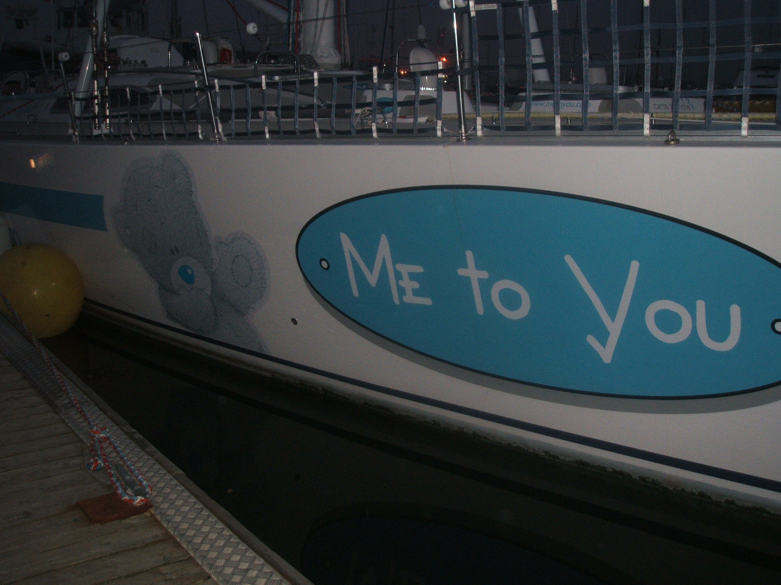

    26 August 2006 at 20:49
    heres is a better angle

    26 August 2006 at 20:55
    Nice work Colin.
    I am not that familiar with boats, did you seal or was it indeed necasary to seal the edges?
  • Colin Hibbitt
    26 August 2006 at 21:12
    They were applied the same way as you would a vehicle – applied wet allowed to dry naturally not sealed – myself and Trevor from new forest signs in hamphire were combining efforts to complete the project – three days before the race started in portmouth harbour we had to apply over 100 business members logos along the top egde approx 700mm long each of the twelve yachts has bow logo to be fitted either side and we hade to transfer 3 whole boats as in photos attached – the weather was awful and we had to work in a dinghy most of the time – the last graphics was applied in the dark around 7pm in the rain a day before the race – apart from that i was glad to hear only one large logo fell off

    26 August 2006 at 21:22
    Looks like you did a good job Colin,
    Hope it was as lucrative as it was difficult.
    Why did one fall off? not being funny or fascisious, was it because the wet application had not dried out properly, as you were on a deadline?
  • Colin Hibbitt
    26 August 2006 at 21:42
    Hi pete,
    The one that got away was a digital printed 4`x3` it was applied in a dinghy by trev in a force 3 gale ie a bit choppy – the graphics was applied right next to the boot line at the bow – it could of been the sticker was still not dry but apparntly when they landed in boston we shipped out another with was applied by themselves but had two weeks to cure but the same thing happened – another was sent using this very expensive vinyl and again it fell off – so we put it down to the surface of the paint as it was only one side
